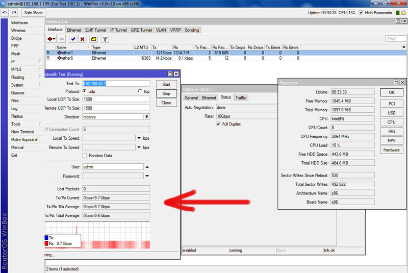

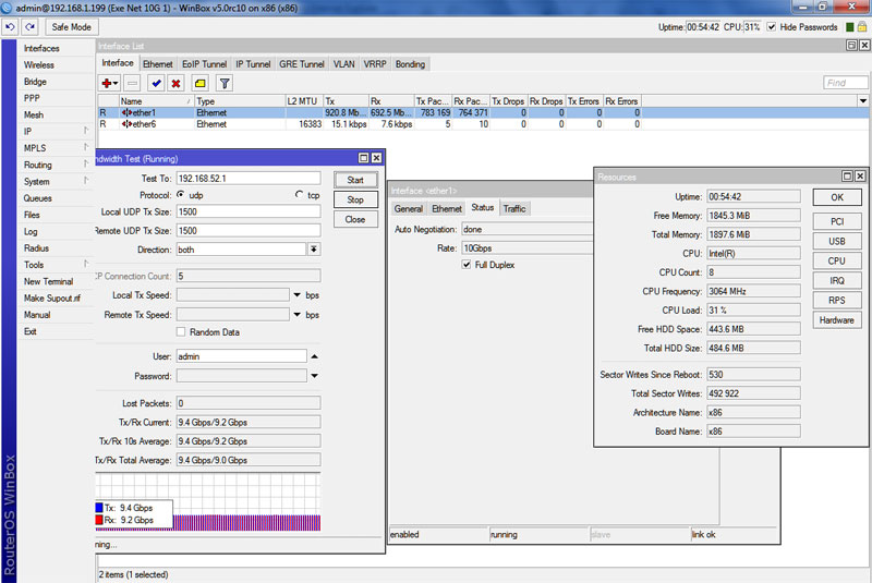

10G with Mikrotik WORKING
We tested it and decided to share with all of you as it was never done before here on forum:
Test is done with intel 10G copper nics, intel 1366 processor to machine with the same setup.
Send:
Receive:
Both:
In interfaces it shows about 1300M, we suppose it is bug. It will be reported to support.

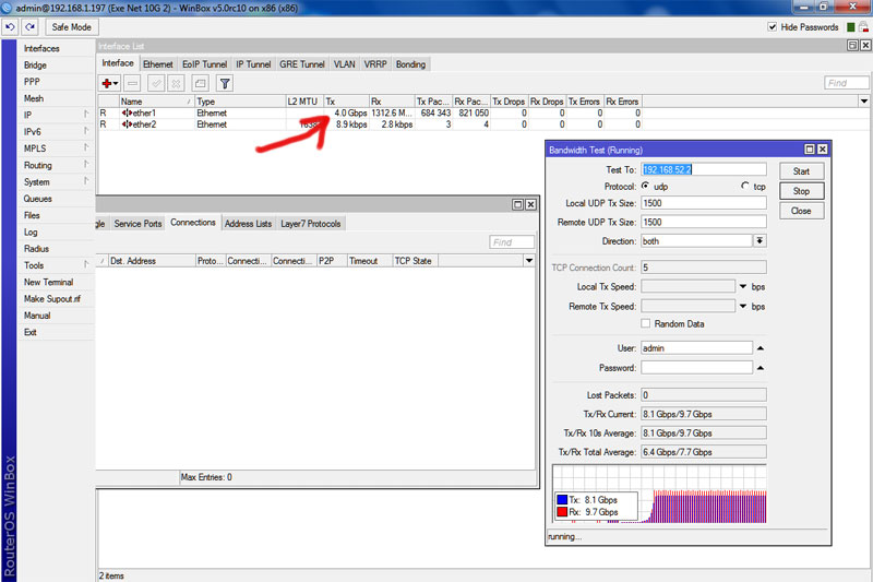

Now turn on contrack :stuck_out_tongue:
Contrack on all the time.
With contrack off, it shows 4G on interfaces, so it seems it is not bug.
