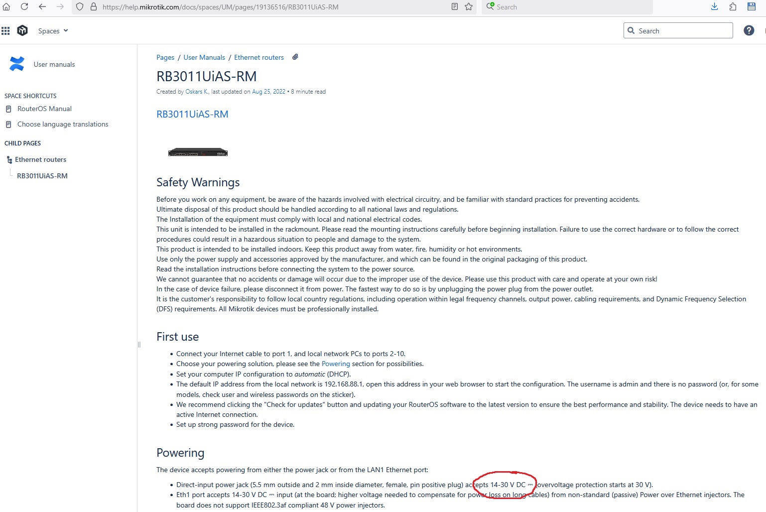

I’m currently running my RB3011 from 24V, because I’ve always thought it needed 14V minimum from the user manual.
However, the web page at MikroTik for it says 10V minimum. It would be handy to be able to run from 12V as I already have a common 12V supply in the rack, but I don’t want to redo all the wiring only to find it isn’t reliable because it really does need >14V.
Anyone know which document is correct?

BTW, both specs and product brochure specify input voltage range of 10V - 30V … the same for both barrel jack and PoE-in. So I don’t see where the idea about minimum 14V came from.
Hmm… I was wondering about that over the last hour, reading the test results. Might upgrade to an RB5009 when funds allow again.
As to the 14V… here:
