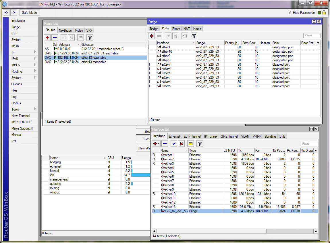

I have an 1100AHx2 with a 1GBps uplink on port 13. Ports 1-10 are in a bridge, serving a /24 subnet.
Even though 1 have 4 servers connected to 4 ports, only 1 of those servers are generating any substantial traffic. It is about 110Mbps with 14000 pps . Even at this light load, I’m loosing 2-3% of packets, up to 14% at times.
The CPU load is 20% and most goes into queuing. I have no filter rules and no firewall rules.
Can anyone point out any problems with this setup that is causing the packet loss? The packet loss is not in my upstream. I can ping my assigned uplink gateway IP without loss. The loss is happening in the router.
