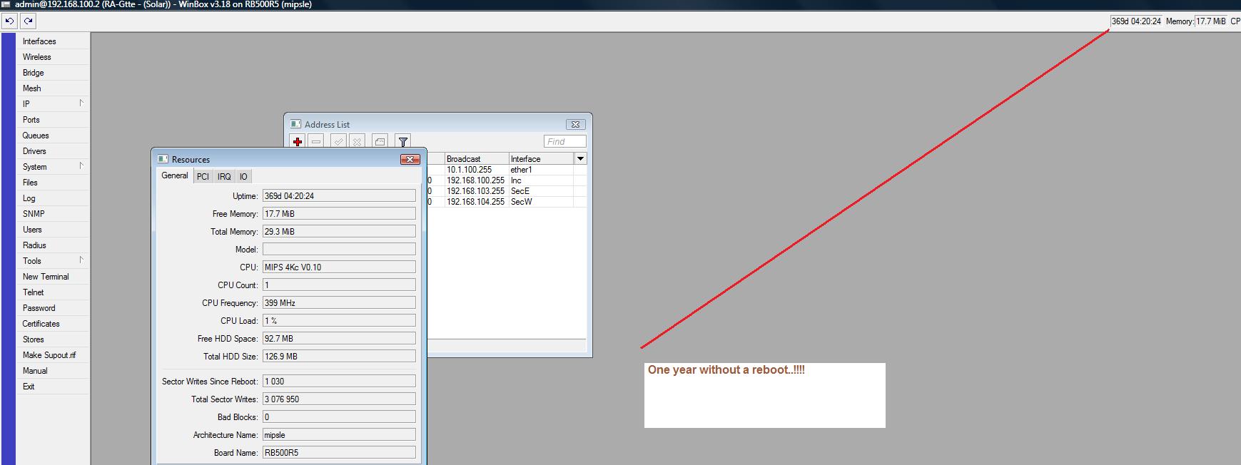

Thought you might find this interesting…
The moral of the story.
If nothing’s wrong. Don’t fix it.

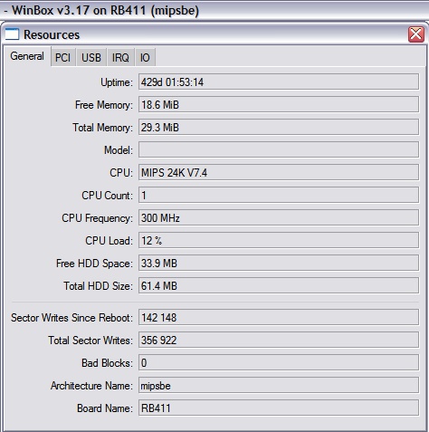

I know this topic is a few months old, but I was just looking at some boards on my network and found this one…
