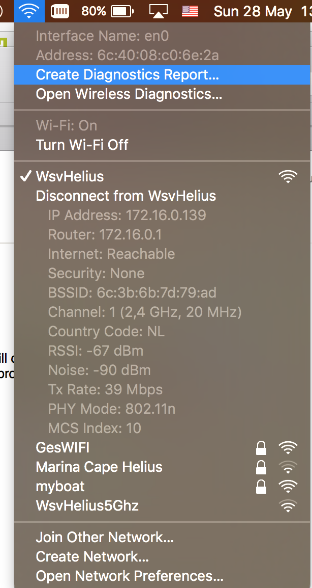

See picture showing the WIFI signal strength details:

First, the SNR (Noise floor - RSSI) is 3!! That is baaaaad. Use a spectrum analyzer to see if you have interference sources nearby. You probably do.
Second, I never liked auto. In 2.4GHz, work with channels 1, 6 and 11, making sure each AP use that pattern. Be very careful about NOT having two APs with the same channel overlaping.
Also, the APs should be setup to transmit at the same power output as your weakest client. What’s the point of having good coverage if your clients can’t be heard!

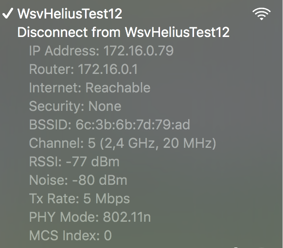

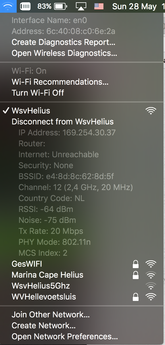

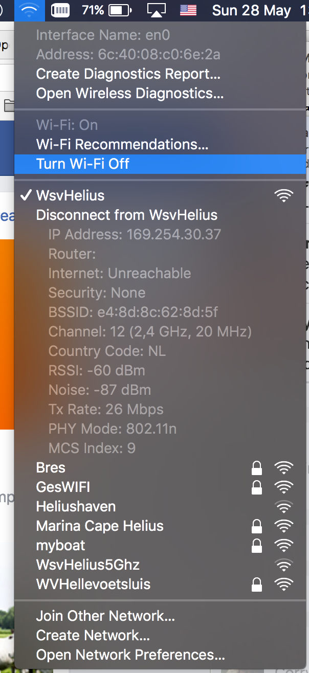

Some screenshots from the Mac WIFI settings below. The SNR seems to be OK, but no internet connection. :frowning:

The second screenshot shows a different channel, so a connection is trying to be made with a different wAP. So maybe indeed I should lower the power.

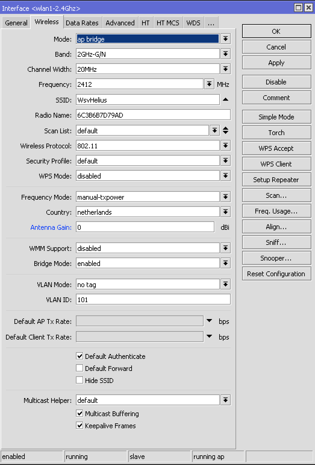

I will post a screenshot of my wAP WIFI config, maybe you can review this config as well. Thanks.
This is an example config of the 2,4Ghz WIFI wAP. Any comments?

Have you verified that this has been effective?
How does 5GHz performance compare to 2.4GHz? Your screenshots only show 2.4GHz.
In two of those screenshots you are associated but don’t have a proper IP address. Are you having DHCP issues? Try setting a manual IP when you’re troubleshooting the wireless - that way, you know you’re troubleshooting wireless, not DHCP and wireless.

set frquency mode to “regulatory domain”
That is what I’m testing right now. And it is not working yet so it doesn’t seem to be effective. What is outstanding is maybe to reduce the TX power of the wAP’s
