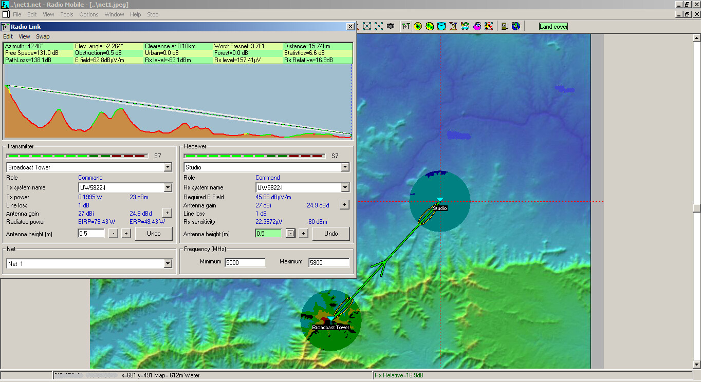

i am planning to use a R711-5Hn (MMCX) board with a 27dBi Panel Antenna to make a 16 kms PTP link.
Radio Mobile has given me great results…
Inputs will be highly appreciated…

What tehre can be added.
calculated should be -63, please have in mind that radio signal always fluctuate, but even if it will drop down to -69 you will still be able to decode maximum modulation.
What is your bandwidth expectations / need ?
What is height at TX end, studio looks like ground level.
My advice would be not to put the link into production until you have experienced all weathers.
Ducting may cause an issue on this service. Since both ends are at extreme elevations, if you have a temperature inversion you may find a loss of 10-20dB as you struggle to get that signal through a layer that is determined to refract it.
Wait for the day when you see smoke from chimney stacks going horizontal and check the signal levels again.
Simon
min. expected bandwidth is 1MB. the more i get will be a bonus for additional VoIP & IP Camera. ![]()
Studio is at 620mtrs. (above sea level) and Broadcast tower is at 1200 mtrs. above sea level. currently one Motorola PTP 100 (Canopy) System is operational. No smokes as there are no chimney’s and max rainfall is around 60mm/hour.
temperature variations are not high either.
motorola PTP100 is currently giving a ping response of ‘2ms’ on this 16kms link.
can i expect similar results from mikrotik? or maybe better ![]()

the link should be fine.
