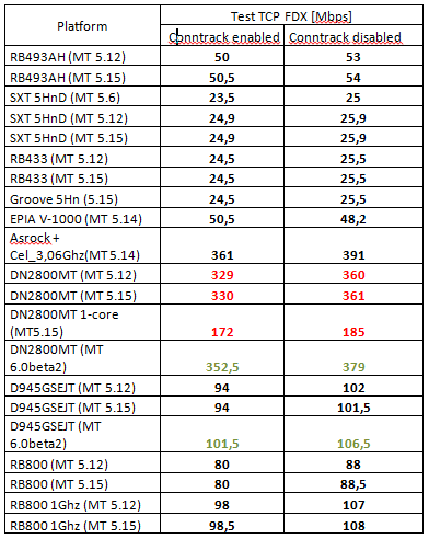

I’m using Intel DN2800MT motherboard:
Here is a comparison of motherboard perfomance:
Ehm, your result table is completely off - i just run simple test Trough my RB493G - that have some configuration on it and with single TCp connection to my linux server i got more than 300Mbps throughput. I’'m sure if i will clear up configuration and will make more TCp connections i will get even more.
Only way i can see you can get these results is if you run test to or from the router or run loopback to itself.
Loopback results are meaningless, they only show that the ATOM has more CPU Cache. See what Macgaiver said above. Correct TCP test procedure will give good results on RouterBOARD devices.

Yes - it’s loopback test. On the router I make BTest to loopback (127.0.0.1)
You did test to linux platform so you had to use Ethernet connection. RB493G has a switch port.
If you do this you are not testing the processor of the platform it self.
Do fdx TCP test to your linux server and post the results.
It was routing test, so all traffic went trough CPU. port–switch1–CPU–switch2–port to be exact.

Like macgaiver pointed out above, TCP loopback test is very misleading and doesn’t show actual performance. You would need to test through the device with actual traffic, or iperf.
Further on in the article they show that doing this actually gives good results, as opposed to loopback test.
