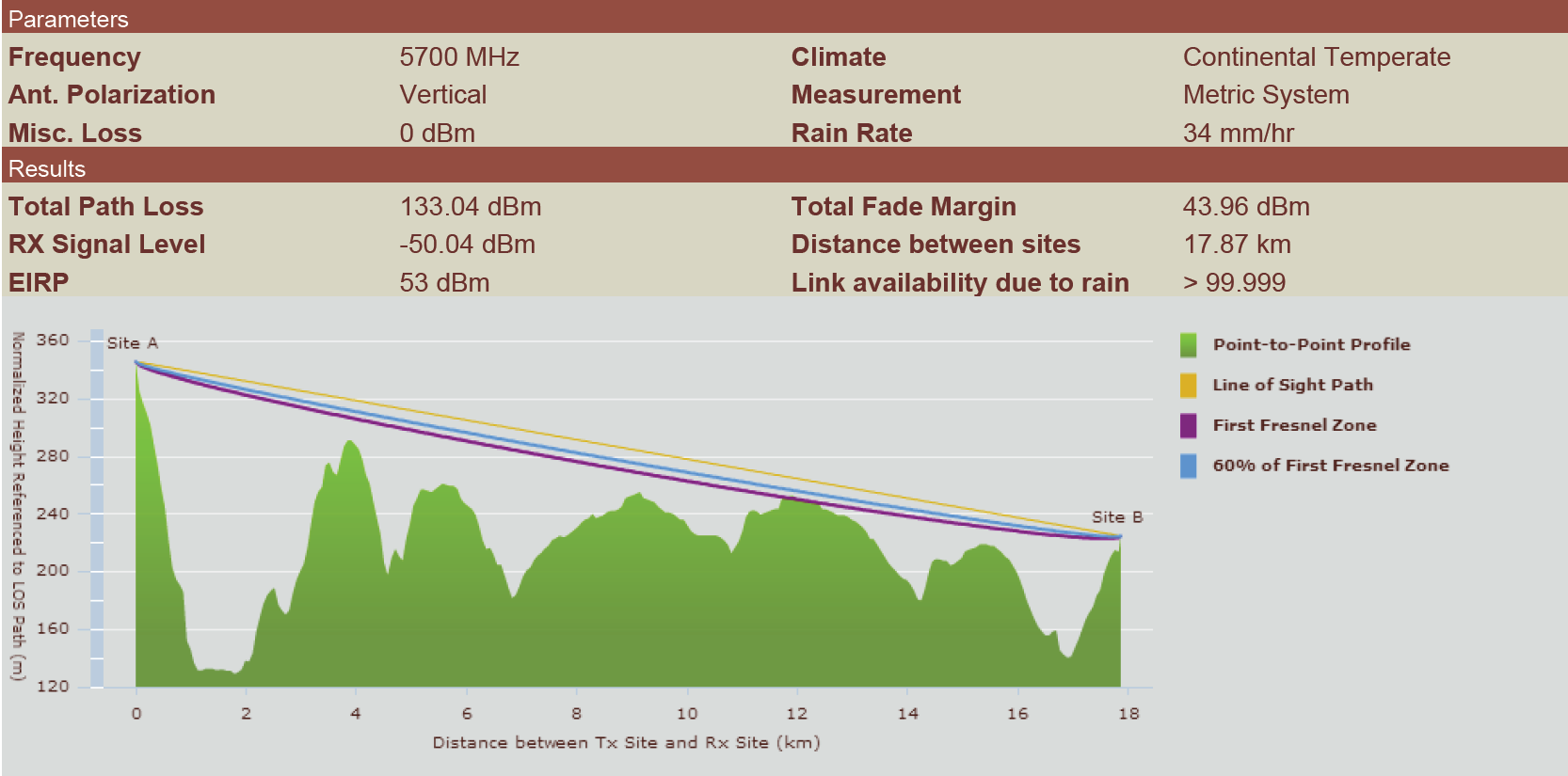

I have also concerns about fresnel zone. I have done theoretical link calculation for this setup, and it’s on the edge. Is there some way I can check if I have issue with frensel zone?

Here is the results that I got from link calculator:

Next time when u go to the hill get a binoculars with u and take a look at the other end… do u see it, cause what I see on the diagram u gave is that you are on the edge and if there are some trees u may have a bigger problemo :slight_smile:
Can I ask how are you measuring performance is it from site A router to site B router or the router before point A and router beyond point B, also you have freznel zone issue at 12kms from point A, to solve increase antenna height(s) at either or both point A + B, reduce wireless scan list from default to +/- 20Mhz above below AP frequency, so for example AP=5765 set wireless scan list to 5745-5785, there is no point in scanning from 5180 to 5865 when you are using 5765.
