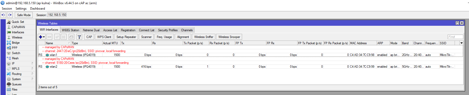

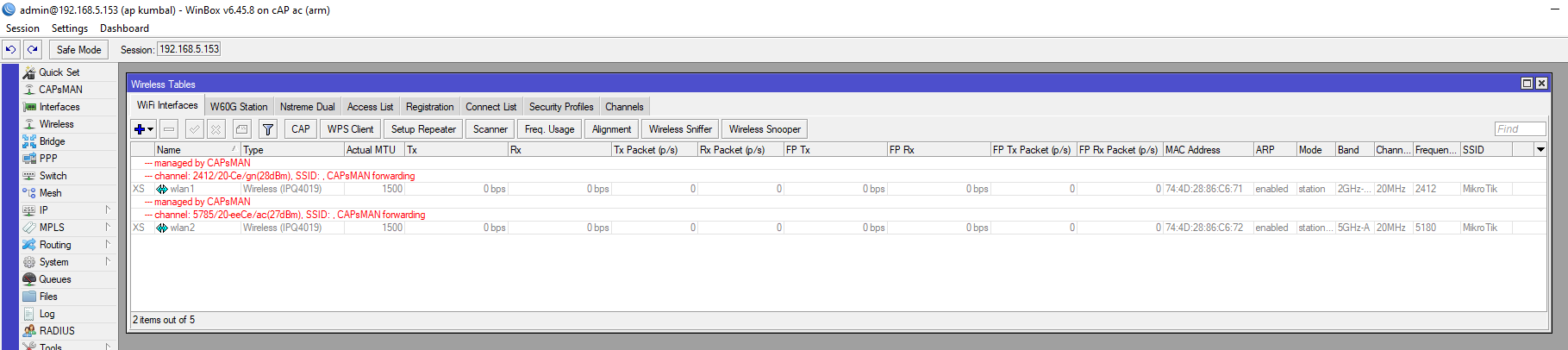

Recently I configured CAPsMAN in my house using Mikrotik’s wiki. I also checked a couple of youtube videos since the screenshots on wiki are related to older version of Winbox but no big deal, I managed to make it work as needed. During the setup I had issues with two AP’s but I suppose that was due to my mistakes related to previously configuring the AP’s. In the end, I performed Netinstall on those two AP’s (resetting config wouldn’t do it). One of those 2 AP’s was fixed completely, in the other one remains a problem which was there before Netinstall - when CAP is activated, the AP won’t transmit SSID. It would only transmit SSID after a config reset, the standard Mikrotik-xxxxx SSID. But when I activate CAP in it, SSID disappears.

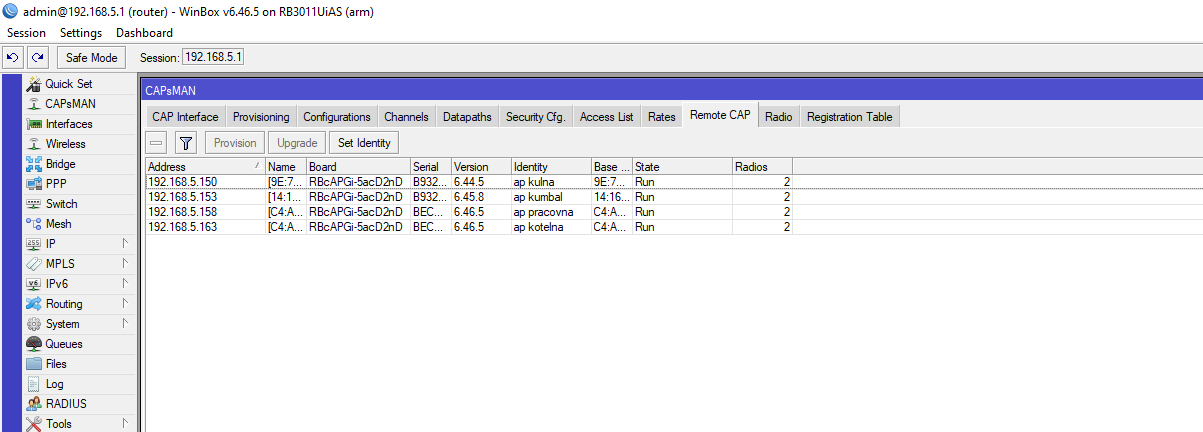

I’m attaching 3 screenshots. IP 1 is the router, IP 150 is the properly working AP and IP 153 is the AP that doesn’t show SSID. I will just add that I never disabled SSID transmission manually, even for testing.

Couple of (related?) things:
  • Make sure you are running the same firmware and RouterOS version
  • Turn down the transmission power, especially on the 2G radio
  • Don’t use extension channels on the 2G radio
Thank you. I did test with the same version of routeros first, I’m aware they are different version now, one is a netinstall (I took long-stable just to be sure), the other one I was afraid to upgrade. I will fix that soon but I don’t believe that is the problem (before netinstall the problematic AP was running on 6.46.5.
The other 2 points I will check and adjust, appreciate the comments.
