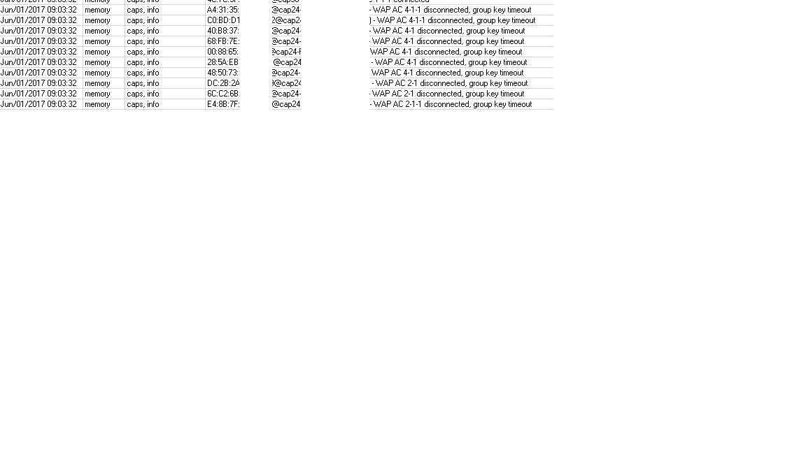

one of my major problems is the concurrent disconnection of clients on 2.4Ghz band
for the last weeks I changed dozens of parameters and did software upgrades and downgrades:
  • logging says: disconnected, group key timeout
