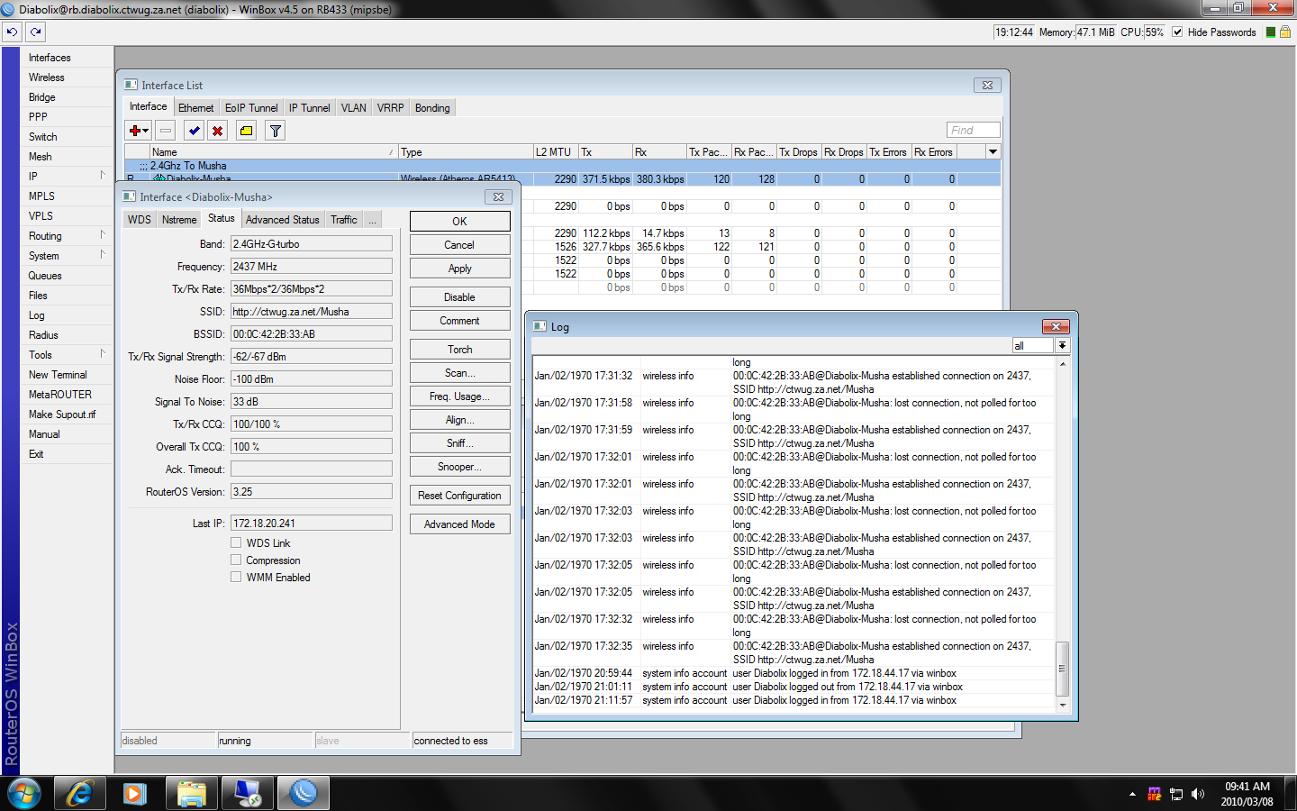

I would like to know if someone has a suggestion as to what my problem can be. I have 2 * 2.4Ghz 24dbi grids both using R52 pointing to eachother. The connection goes through one tree but the distance is under 200meters. As you can see in the attached picture , my signal is good and stable aswell as my CCQ , but i keep getting the “Lost connection , not polled for too long” error. Can anybody perhaps help me ?

An R52 + 24db Grid 200 meters from R52 + 24 Grid?
You should be getting Way higher than -62/-67, even with a tree in between.
Did you reduce the output power?
If i reduce it the signal goes lower , -71’ish . I tried moving the grids , but moving them even cm’s makes the signal go balistic into the -80’s. Could it maybe be the microwave ? lol
Something’s obviously very wrong.

I have checked everything and everything is properly connected and secure. I think the problem is from interference ? I tested with my microwave and the signal dropped constantly , how can i block the interference from the microwave ? Any settings i can change in the ROS itself to prevent the link from dropping ?
