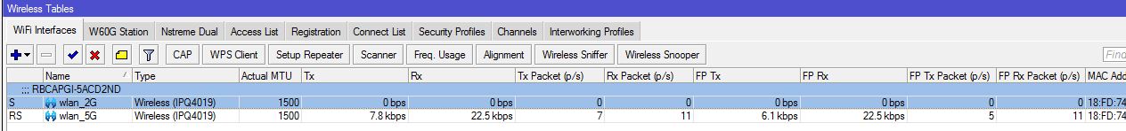

After few hours SSID for 2,4GHz disappears and all devices are disconnected. Tx and Rx is only 0.0 kbps. changing the settings doesn’t help. Helps only manual reboot. After reboot everything works fine.

there are 22 connected devices in 2,4GHz . These devices are only 2,4GHz. When there is a problem with the network, they are all disconnected. At the same time the network 5GHz is working fine.
SSID is not broadcasted
disable&enalbe Wlan_2G doesn't help. Helps only System >> Reboot

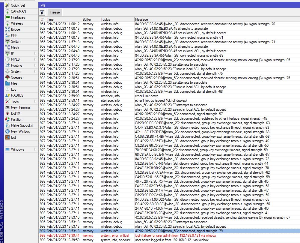

Tue Jan 17 I moved google nest mni and chromecast devices to 5GHz network and until today everything worked fine.
Today at 13:27 the network crashed :frowning:
2GHz network: group key exchange timeout.
Looks like clients didn’t get the WPA/WPA2 key-change information. They will stop ALL being able to encrypt/decrypt properly.
