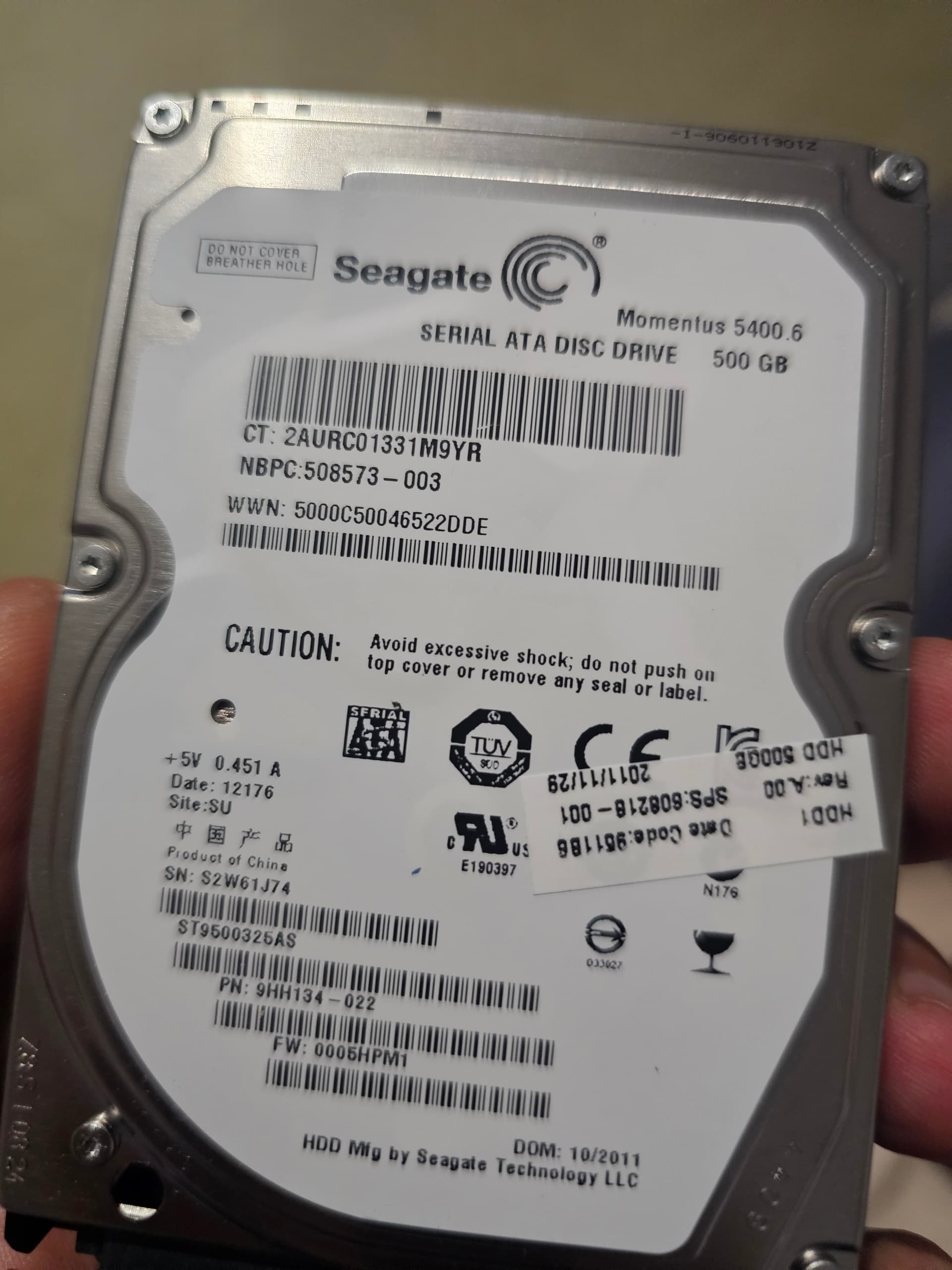

This is hdd inside. Its some Seegate momentus 500gb hdd.
Is this ok for usb power?

451mA that even can be powered by old USB2 ports (max500). I doubt that a SSD (or nvme) could draw less power. Nvme can be very very hungry.
:+1: for giving this old disk a second, meaningful life. Don't worry about your RB.
