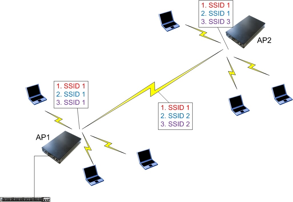

First of all I must say that I am a beginner in wireless networking and I must ask for some help and explanation.
Basically I have the following situation - now there is one AP for the client computers, but the coverage in some rooms is not good. So now there is a need for extension of this wireless network. I attached a picture.
I have the following questions:
  1. Is it possible that AP1 has the same SSID for the clients and for the connection towards AP2. The same applies for AP2?
  2. Solution 2 is the same SSID for the clients on both APs and different SSID for connection between APs. I suppose this could work. What are the drawbacks of such solution?
  3. Different SSID for clients on each APs and for connection between APs. Suppose this is a best solution.
I suppose I need two radio cards in each AP - one for clients and one for connection towards peer AP. Is there a possibility to configure this with only one card?
Can you please provide me with some example configurations or some “how to” configure this?
This can work on one card,
try this one
http://wiki.mikrotik.com/wiki/Transparently_Bridge_two_Networks
instead of AP-STATION where will AP-AP both connecting using WDS
