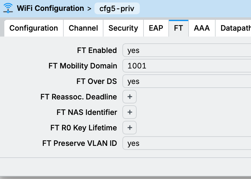

Take a look at this config which works for me:
/interface/wifi print detail
Flags: M - MASTER; D - DYNAMIC, N - NETWORK; B - BOUND; X - DISABLED, I - INACTIVE, R - RUNNING
0 MDB ;;; operated by CAP XX:XX:XX:XX:XX:XX%VLAN_MGMT, traffic processing on CAP
cap="AP Floor -1@....." name="AP Floor -1 (2G)" mac-address=XX:XX:XX:XX:XX:XX arp-timeout=auto radio-mac=XX:XX:XX:XX:XX:XX configuration=cfg24-priv
configuration.country=Luxembourg .ssid="MySSID"
security.authentication-types=wpa3-psk .management-protection=required .wps=disable .ft=yes .ft-mobility-domain=0x1001 .ft-over-ds=yes .ft-preserve-vlanid=yes
datapath.bridge=bridge .traffic-processing=on-cap .vlan-id=10
channel.frequency=2412,2437,2462 .width=20/40mhz
steering.rrm=yes .wnm=yes
Settings from WIFI->Configuration:
They overlap quite considerably.
Thanks for sharing your configuration. The only notable difference between your config and mine is that you're using wpa3-psk instead of wpa2-psk, and that you set fixed channel frequencies instead of letting RouterOS make that decision.
