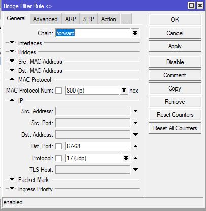

I’m using bridge filter for this.
/interface bridge filter
add action=drop chain=forward comment=dhcp dst-port=67-68 ip-protocol=udp mac-protocol=ip out-interface=eoip-siteA
add action=drop chain=forward comment=dhcp dst-port=67-68 ip-protocol=udp mac-protocol=ip in-interface=eoip-siteA

Drop forwarding of UDP packets to ports 67-68 in the Bridge Filters
PS This rule can also protect network from other DHCP, its work will be limited to one port Mikrotik to network segments connected to other ports will not spread.
