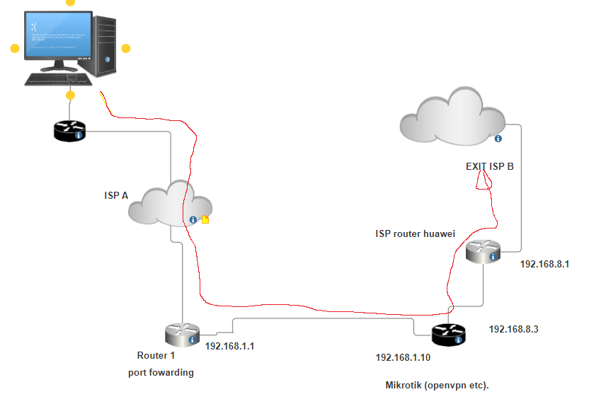

so i want to create a vpn that incoming from ISP A and exit to ISP B, because for some reason ISP A cannot open certain web. and ISP B speed is very fast.
so im imagine using open vpn to connect to the mikrotik from ISP A and exit to ISP B is that possible? and the ISP B cannot do port forwarding.
i tried to configure but getting nowhere.

well my pc is on another place / city. ISB B has unlimited traffic internet and no traffic limitation can open any web. so i must connect it to my office, which has 2 internet. . ISP A and ISP B. but sadly ISP B dont accept, ip forwarding and cannot reach the mikrotik or vpn server behiund it. if i set it up behind ISP B. but can reach it with ISP A. so my idea is reach from isp A and exit thru ISP B.

If the routers were switched, it may be doable as you could VPN into Mikrotik connected to ISPA.
Then you would simply make the connection to ROUTERB as WAN2 on router MT getting a private IP on that LAN connection
DHCP provided by router2…
One would source nat out WAN2 on the mikrotik and then your internet traffic should flow just fine.
Of course one would have to take care of some routing on the MT and some firewall rules but all doable

As stated much more is possible if you switch positions of the routers.
