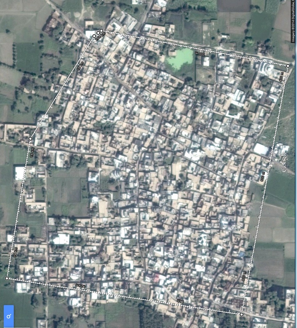

village in 2km , no interference/dsl/cable/or other wisp
population 5000
more then 2000 houses
advise or mark the map for best coverage, i can install equipments anywhere in village or out side the village
population 5000

Don’t see any cars nor electricity lanes. The question is if there are at least some people with computers willing to subscribe the Internet connection. I would not afraid of self interference as nearby houses can share one wifi client by cables. The question is also what bandwidth will be provided in total.

can you please point out the area on map where i install sectors or omni and routerboard models thx.pin the point on map so i install on that point and also tell me best for setup and coverage 90°-120°-160° and 19dbi sector or any other also thanks. 75% population just want use skype.

My way would be to build 120 degree 5G ap points in the four corners of the vilage at some height enough (around 3-5m) over the roofs with slight slope down - as clients should be around axis, so probably below the level of AP antenna. Netbox5, Basebox5 or Netmetal5 would be good. You have also possibility to add one additional wifi card and split the antenna to two in the future, if necessary due to large number of connected clients. Use narrow channel, tune the power to the lowest yet working level in order not to scream too far. Connect close clients with panel CPE devices (like SXT5Lite). As the buildings are very close to each other, use one client with switch per small group of clients connected by wire. Let them use their 2.4G router to connect all their wifi things.
Connect the corner APs to the central point where you have your connection line out, preferably by point-to-point links, each on different frequency (again 2 SXT5Lite will be fine, using some more directional antennas would be better, you can change it in the future if necessary and use the SXT5Lite at clients place). There you need to put your main router - probably something like 1100ahx2 or 850gx2 or ccr1009. All are overkill, but you need to have some reserve for firewall rules processing, mangling, queues and such things that are cpu power consuming.
