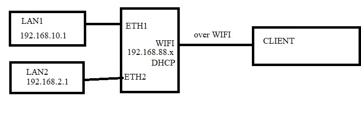

2 LANS over WIFI
I have Map2nd router/ap
I have 2 different lans, LAN1 - 192.168.10.1 and LAN2 - 192.168.2.1
I want to configure the router what i connect LAN1 to ETH1, LAN2 to ETH2
Both LANs can be reachable with WIFI (good Wifi with DHCP server for clients)
No internet needed for LANS

Add virtual WiFi. Add 2 bridges. Put in the bridge1 eth1 and wifi for LAN1 segment. Put in the bridge2 eth2 and virtual wifi for LAN2 segment. Move IP addresses to the bridges from eth1 and eth2.

Its in industry, controler is in Lan1, other device is in Lan2. We want conect both lans and client connecting to router via wifi can do diagnostic and other job in both lans

As per @Anav, I would put IP addresses .10.1 and .2.1 on the 2 physical interfaces
(.88.1 can probably remain on the default bridge)
  1. I would customize the MAP DHCP server, so wireless clients get routes to .2.x and .10.x and no default gateway.
/ip dhcp-server option
add code=121 name=classless value=0x18c0a802c0a8580118c0a80ac0a85801 \
  comment="classless routes to 192.168.2.0/24, 192.168.10.0/24 via 192.168.88.1"
# You may have to remove the existing default entry, to add the following
add address=192.168.88.0/24 comment="no default gateway, with classless routes" dhcp-option=classless dns-none=yes
I would then put back in the default set of firewall rules.
And make both ether1 and ether2 members of the Wan interface list.
So clients connecting to the Industrial devices are NATTED and look like they are coming from 192.168.2.1 (or .10.1)
Also means Industrial devices cannot connect back to clients.
You may not want this (perhaps for logging correct client IP addresses on the industrial devices)
In which case you can disable the default edit src-nat masquerade (was dst-nat) * rule. (This does require the industrial devices have the MAP as their default gateway)
