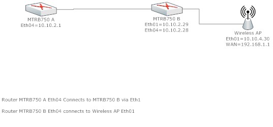

I am trying to connect 2 MTRB750’s together and I cant seem to get the IP addressing correct.
In MTRB750 B everytime I try to address eth4 to 10.10.2.28 the route for that IP comes up blue. Am I missing something here? I am trying to treat MTRB750 B Eth1 as the port that connects to MTRB750 A, which seems to work fine. Now, I can use eth2 and create a 192.168.88.1 and give it DHCP and that seems to work fine. The issue seems to be when 2 ports have 10.10.2.x address one of them wont work.

You’d have to bridge or switch those ports. A router cannot have two routed interfaces on the same broadcast domain.
There is probably a better way. Routing is usually preferable to bridging and switching.
The reason why I wanted them routed this way is because I want to be able to log into all the equipment when need be. I wanted to create a routed network because the broadcasts when alot of people connect to the ap’s seem to be a real big problem. This is just a single segment of the network that I have now. Behind Router A is the “internet”. This is a completely nat’ed network. There are alot more hops between wireless equip but I just needed this basic setup so I could do what I needed to do :slight_smile:.
Now I could really care less what range the eqiupment stays on but when im behind router A and I cant log into eqiupment when its on another range thats a big problem. Id much rather stay away from bridging and switching if at all possible.
