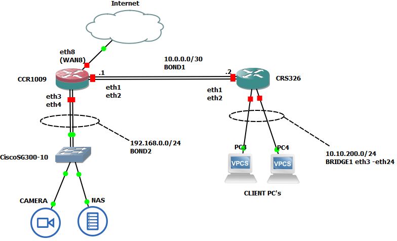

Its been a while since I have use a Mikrotik device. I was using a CCR1009 for a few years and moved and had no need for it. I now have a use for the CCR1009 and decided to boot er’ up and configure it..
I want to use the CCR1009 to act as my main firewall and also provide 2 bonding interfaces. One bond will be used to connect to a CRS326 to provide client PC’s with access to the internet and the second bond will be used to connect to a Cisco SG300-10. The Cisco will provide connections to security cameras and NAS devices.
I’d like the Client PC’s (10.10.200.0/24) to be able to access the security camera’s, internet and NAS but, would like the firewall to block NAS and Cameras (192.168.0.0/24) from accessing the internet. How do I achieve this with firewall rules? I plan on updating the NAS and Cameras manually by downloading any updates required from a client PC..
I also have a question regarding the masquerade and wondered if that is setup correctly? I’ve seen other Masquerade rules where the source address is used and not used..
I’ve included the configs from the CCR1009 and the CRS326 below and also a network topology. I am just looking for someone to pick apart what I have done so far and point out any issues or perhaps any improvements. I am also a little fuzzy on firewall configuration and would also like to include rules to filter out BOGON ip addresses. So, a little guidance on the firewall and what should be in there to protect the router and the rest of the network would be appreciated. I plan on using this in a residential setting..
This topology has not gone live yet and is just sitting on my workbench as a test lab..
Thanks in advance.
