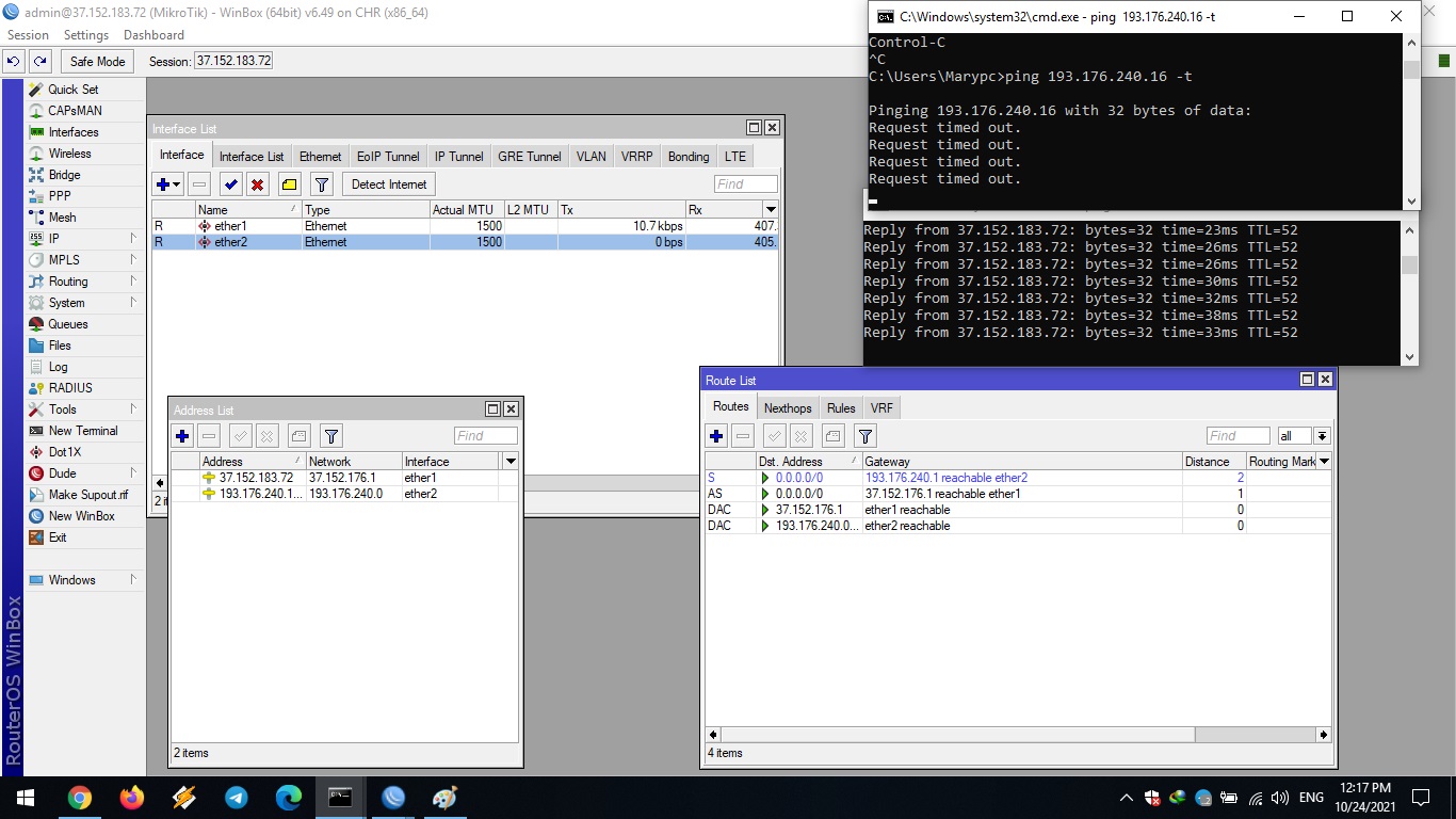

how to add 2 public ip in mikrotik ? just one ip worked !

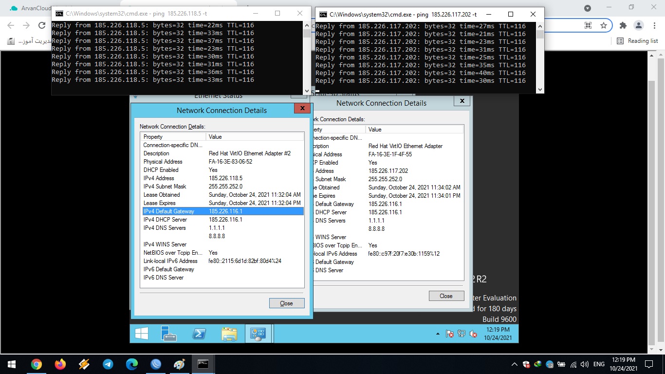

in windows just assign ip in ethernet and work fine
please see a picture attach

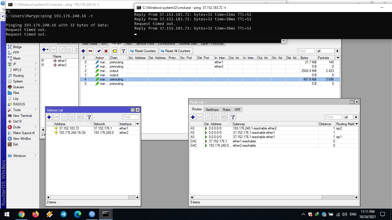

https://mum.mikrotik.com/presentations/PL12/Load_Balancing_workshop.pdf
See page 21: mark incoming connections so that the answer uses the same connection
not working
Post an export as per my automatic signature below rather than screenshots where half of the necessary info is missing.
@bpwl advice exactly what you need to do.
Just copy/paste (i’m assuming that you have done correctly)
just im wondering where is your LAN ip?
Regarding your last picture, i’m not able to see it
As there is not any packet matching your mark-connection in prerouting, that mans packet from outside does not even reach to router and problem is in ISP that is not routing traffic toward your router.
@ingdaka is probably right, but maybe there is some match condition other than in-interface=ether2, which did no fit to the screenshot. Hard to guess without the export.
