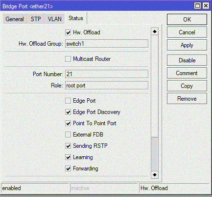

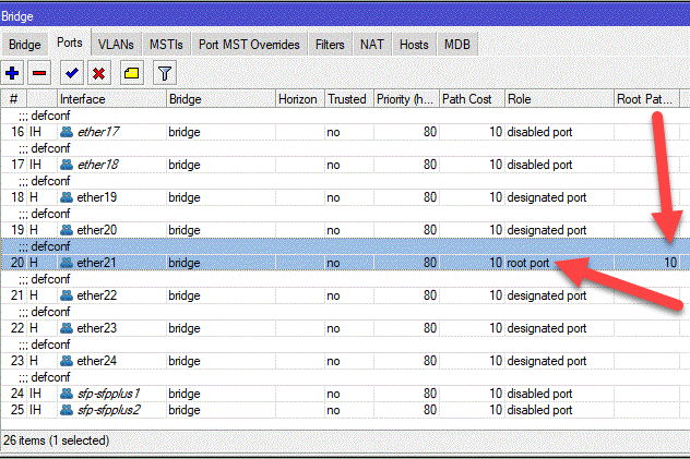

The Problem is that RouterOS running on the CRS326 converts ether21 … the Trunk Port into a Root Port … 2 illustration follow:

The root port role is orthogonal to trunk port role - the former says that the spanning tree protocol has determined that the shortest path to the root bridge goes through that port, the latter says that the port is a member of more than one VLAN. So the mere fact that the RB260-facing port at the CRS326 is marked as a root one just means that the RB260 became a root bridge in the STP topology, because RSTP protocol is enabled on both devices and ports in question, and the numeric value of the RB260’s MAC address is lower than the one of the CRS326.
So check which VLANs are allowed on the interfaces at both devices, which of them is tagless, etc.
As there is currently no loop in your physical topology, you can also completely disable STP on both devices until you resolve the actual issue.
@sindy, thank you.
On the RB260GS I disabled RSTP only on the Trunk port [ether1] and that solved the problem.
