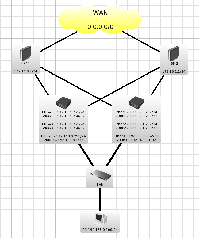

No, I’ve 1 Lan → 2 MT → 2 WAN, the problem is that if the WAN connection with distance 1 gets down, until the connection is severed it will try to get out through the same route.
Deleted because not related.
I’ve 2 ISP both connected to 2 RB2011 and this two also conected to the same Lan with VRRP on the three interfaces.
The problem is that if I do a ping from the Lan to the WAN and what I lose is the WAN connection with Distance 1 then, I’ve to drop the connection, wait around 10s and then start again. However is what a lose is the master RB2011 all work without interruption.

Can you do a test using scenario 2 ?
Open a cmd and type “ping -t 8.8.8.8” for a continous ping. Once it has started pull from the RB the cable of the ISP1 and see what happends.
The desired effect is that the RB automaticly detects that the ISP1 path is down and rerouted the connection throught ISP2 but it doesn’t do it.
