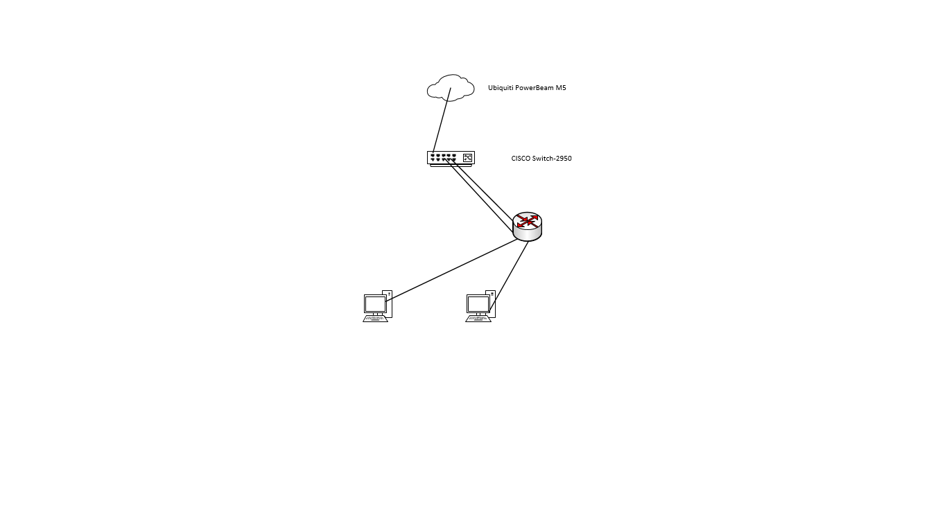

Hey Community’
I need to know that how can I configure 2 up-links in mikrotik. I have attached network diagram for review. In network diagram Upiquiti device connected to CISCO 2950 Switch. In mikrotik 2 ports configured as WAN1 & WAN2 & 2 ports are configured LAN1 & LAN2. If I send all the traffic using WAN1 it’s working well but WAN2 isn’t working. Please suggest how can I deploy both WAN1 & WAN2 as working condition.
Any other configuration will be provided.
Regards’
If you want LAN1 to use WAN1 and LAN2 to use WAN2, you should configure policy routing.
https://wiki.mikrotik.com/wiki/Policy_Base_Routing
If you want to configure load balancing, RouterOS has many load balancing methods, I would suggest PCC.
https://wiki.mikrotik.com/wiki/Manual:PCC
