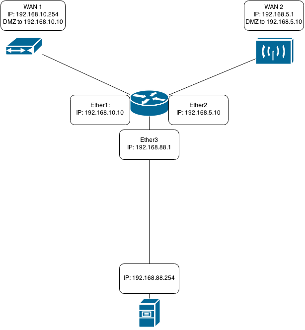

Hello everyone,
I am trying to set up my MikroTik router to use 2 WAN connections with the following requirements - one of the connections should be primary, and the other one - secondary - all outbond traffic should pass through the primary WAN connection (when available) and if there is a problem with the primary WAN connection - the outbond traffic must switch to the secondary WAN connection. Both WAN ports must be simultaneously open for inbound connections.
At the end of this post you’ll find a summarized scheme of my network topology.
Currently I managed to get everything working exactly as I want - with one notable exception - I am using DMZ on both WAN modems. In order to maintain the possibility to reach their web interfaces I have created port forwarding rules that point back to the LAN interfaces of the modems. Unfortunately reaching their web interface is possible only when using the currently active WAN.
Would you please give me a hint how can I overcome this? Thank you!
Yup, that would be correct since you don’t mark inbound packets, therefore they will be directed to the currently active default route with no routing marks.
The solution is to also mark the inbound traffic on both wan and then redirect then back to their wan ports.
