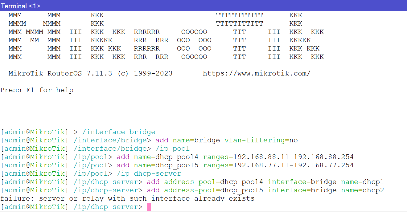

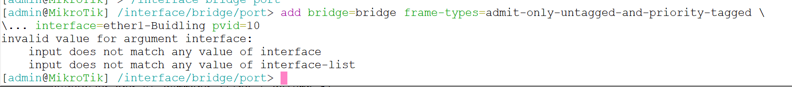

  1. Some of the commands you’ve posted are returning “bad command” from the WinBox terminal; perhaps it’s a version issue?
    Anyhow, I’ve tried to apply them on the GUI as much as I could do the correlation.

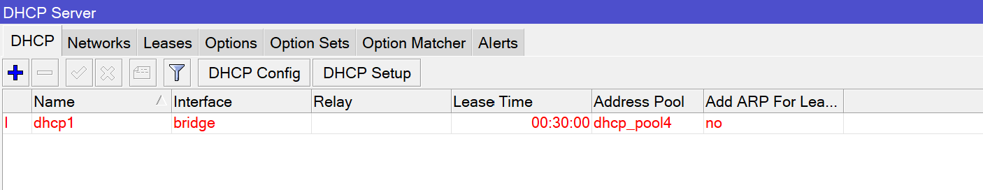

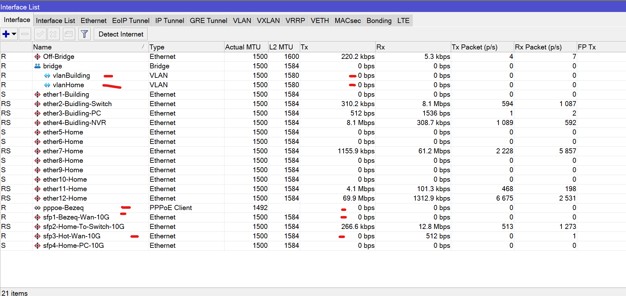

  1. After Applying the config, I lost connection with the router admin terminal; I was only able to gain it back using port “13” which is “Off Bridge”
  2. Now I don’t have internet in any network devices connected (though I’m able to pull 8.8.8.8 ping from the terminal)
  3. DHCP Servers are marked red as inactive. I don’t know why.
  4. On my PC I’m getting “undefined network” next to my ethernet network card connection.
Here is the current configuration, maybe you can help me out from this point?

Changes to the current config:
You slay me with some stuff you added that I didnt recommend LOL.
For example I gave you this:
add name=bridge vlan-filtering=no { change to yes as the last step in configuration }
and you config this...........
add frame-types=admit-only-untagged-and-priority-tagged name=bridge pvid=1
vlan-filtering=yes ( assuming the No went to Yes at the end )
Another example, adding Relay to ip dhpc-server settings, a non-standard entry out of the blue ?????
Changes to the current config: Yes, suggest make all changed FROM off bridge access!!!
You never configured a firewall address list called AUTHORIZED and thus if you actually enable and put in the last rule in the input chain, block all else you WILL lock yourself out.
model = CCR2116-12G-4S+
add name=bridge vlan-filtering=off
{ turn on at end of config process }
add name=dhcp_pool4 ranges=192.168.88.11-192.168.88.254
add name=dhcp_pool5 ranges=192.168.77.11-192.168.77.254
/ip dhcp-server { no need to relay, unless you can explain why! }
add address-pool=dhcp_pool4 interface=bridge name=dhcp1
add address-pool=dhcp_pool5 interface=bridge name=dhcp2
/interface bridge port { I put the ports in order }
add bridge=bridge frame-types=admit-only-untagged-and-priority-tagged
interface=ether1-Buidling pvid=10
interface=ether2-Buidling-Switch pvid=10
interface=ether3-Buidling-PC pvid=10
interface=ether4-Buidling-NVR pvid=10
interface=ether5-Home pvid=5
interface=ether6-Home pvid=5
interface=ether7-Home pvid=5
interface=ether8-Home pvid=5
interface=ether9-Home pvid=5
interface=ether10-Home pvid=5
interface=ether11-Home pvid=5
interface=ether12-Home pvid=5
interface=sfp2-Home-To-Switch-10G pvid=5
interface=sfp4-Home-PC-10G pvid=5

The reason I put “Relay” in the DHCP Server is due to “failure: server or relay with such interface already exists”
I’m getting on the terminal when I apply the 2nd DHCP without Relay. See the print screen attached.
any idea why?
So, putting aside that I was not able to create the 2nd DHCP Server

Ahh okay, the bridge is not the interface, I should have noticed that…,
Wrong:
Correct:
add address-pool=dhcp_pool4 interface=vlanHome=dhcp1
add address-pool=dhcp_pool5 interface=vlanBuilding name=dhcp2
All should be smooth sailing after those changes…
Changed, DHCP is not red anymore; however, it is still an “unidentified network” on PC connected to ether3 and set to get Dynamic IP or set to 192.168.77.5
also no internet from PC. (ping work on router terminal)
also, DHCP don’t show any “leases” (and there should be many)
also look at the “0” transfer rates over the interfaces; something is wrong, maybe on the firewall or the routing.
Dont see anything obvious.
