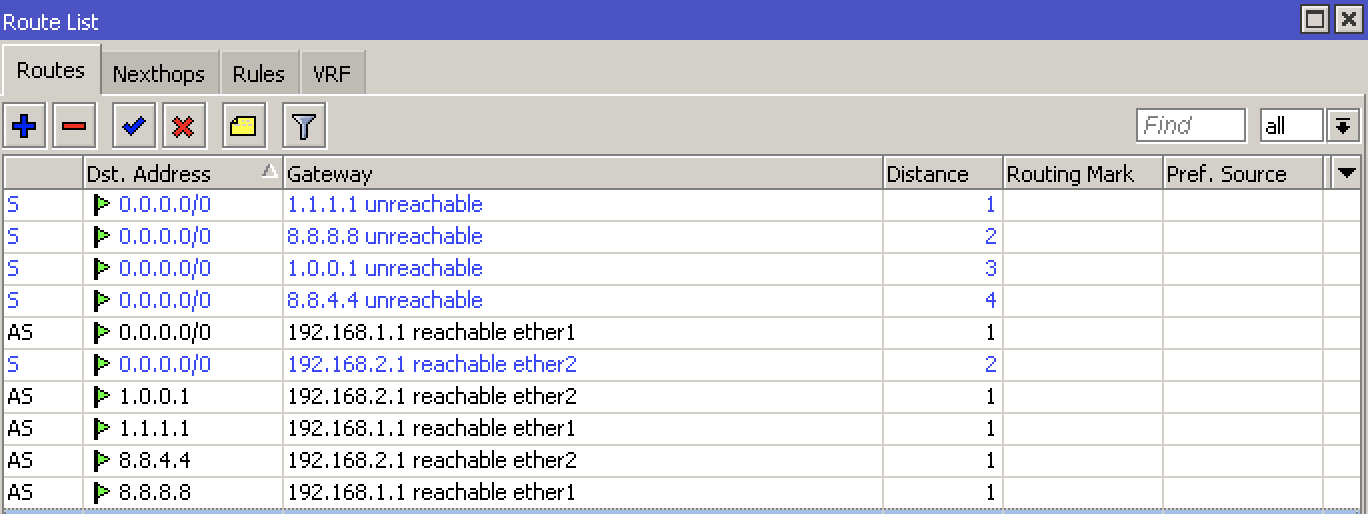

My setup:
  • Ether 1: main Internet connection – DHCP client from gateway 192.168.1.1. Default route = disabled
  • Ether 2: secondary Internet connection (metered/LTE) – DHCP client from gateway 192.168.2.1. Default route = disabled
  • Ether 3 to 5: bridge / LAN ports
My objetive: check if external addresses are reachable in ether1. If not, route WAN to ether2. Re-route back to ether1 when the external addresses become available.
I make the IP Route, following the instructions of previous post:
Adding external addresses via both gateways:
add dst-address=1.1.1.1 gateway=192.168.1.1
add dst-address=8.8.8.8 gateway=192.168.1.1
add dst-address=1.0.0.1 gateway=192.168.2.1
add dst-address=8.8.4.4 gateway=192.168.2.1
Checking ping of external addresses:
add distance=1 gateway=1.1.1.1 check-gateway=ping
add distance=2 gateway=8.8.8.8 check-gateway=ping
add distance=3 gateway=1.0.0.1 check-gateway=ping
add distance=4 gateway=8.8.4.4 check-gateway=ping
Adding routes with distances:
add destination=0.0.0.0/0 gateway=192.168.1.1 distance=1
add destination= 0.0.0.0/0 gateway=192.168.2.1 distance=2
The result is:
I see that the second piece of commands (adding external address as routes and checking ping) all marked as unreachable.
If I took out the ether1 cable, MK starts to route thru ether2 correctly. But, I’m not sure that this will happen if the ether1 gateway is there, with no Internet.
So, my question is: am I doing this correctly?
Thank you!
Should work as its same as I do.
Maybe just use an IP address instead of 8.8.8.8 that does not respond to a ping …
As that IP address does not responds the route will be disabled.
looks like you did not specify scope and target-scope
have a look here:
http://forum.mikrotik.com/t/advanced-routing-failover-without-scripting/136599/1
and more details here
https://wiki.mikrotik.com/wiki/Manual:Using_scope_and_target-scope_attributes
usually, you need to make script for this purpose, but there’s easy trick to perform this based on your setup without script.
first, modify the routes
add gateway=192.168.1.1 distance=10 comment="ISP1"
add gateway=192.168.2.1 distance=20 comment="ISP2'
then assign routes to ip address to check using specific gateway:
add dst-address=8.8.8.8 gateway=192.168.1.1 distance=5
add dst-address=8.8.4.4 gateway=192.168.1.2 distance=5
then use netwatch to ping those ip addresses, also a simple command to enable or disable the route:
/tool netwatch
add down-script="/ip route set [find comment=\"ISP1\"] distance=250" host=8.8.8.8 up-script="/ip route set [find comment=\"ISP1\"] distance=10"
add down-script="/ip route set [find comment=\"ISP2\"] distance=250" host=8.8.4.4 up-script="/ip route set [find comment=\"ISP2\"] distance=20"
and all set.
this will make traffic to 8.8.8.8 will use ISP 1 and traffic to 8.8.4.4 will use ISP 2, then you just ping that ip address using netwatch. if netwatch cannot reach the destination ip (status down), it will lower the distance of the gateway of the specific ISP. it will be reverted back when the ping success (status up) again.
