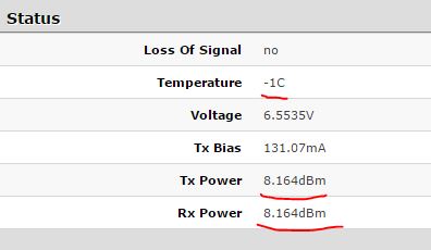

All values in SFP-state page is freeze.
Screenshot is actual for both RB260.
