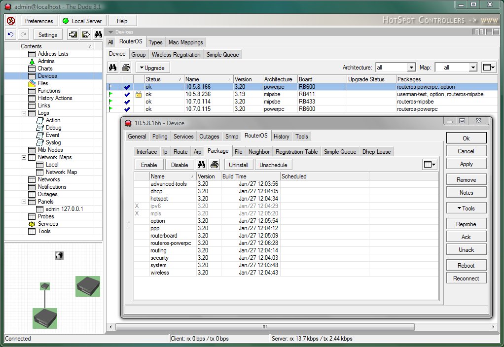

how about Dude? it’s exactly meant for these kinds of multi-router management scenarios
I agree, Dude might be the ´killer´ application that works for that. I do believe in that.
I have only two problems with ´Dude´ which stops me from using:
  1. Last week installed latest Dude package on Windows PC and ran ´discovery´ tool. It started good, found some of my networks fine but then all remote networks became empty and only the LAN Dude works in is visible. Now whatever I try, networks behind a router don’t exist any more. Tried the same on a laptop, same result. So gave up for now, have no time to start trouble shooting here and its exactly the same problem I had two years ago when I tried it.
  2. Dude can run on a rb for a remote segment of my physical network. But I installed the package, and tried to use is as agent from the running main package. No access possible! I seem not to be able to reach the agent…
Conclusion:
Dude might work, I have the believe it will. But if that takes now as much time to learn and ´try and error´ find out how to work with it as the rest of ROS, it takes me another year.
So far winbox works very nice with me, but some minor improvements would make life easier if you only use winbox.
Sure, if I have more time in the future (there are only 24 hours in a day!) I will start to chew on the dude. For now I just eat what I already know how it tastes.
  1. dude can’t “see” what you can’t ping
  2. you have to configure the dude on RB first
