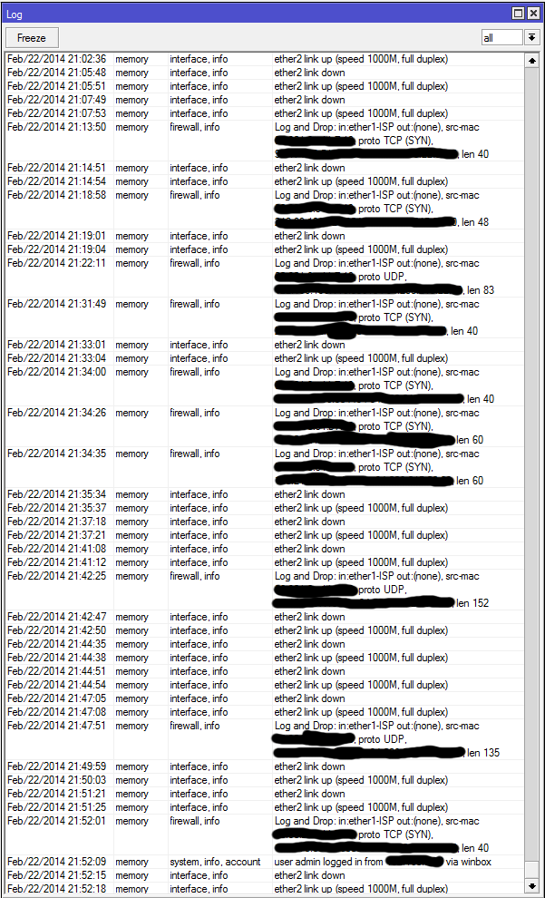

The lag/stutters still remained so i went ahead and checked the logging of the device. What i see a lot is the Ethernet 2 interface constantly going down and up again within a 3 second timespan and when that happens is when XBMC starts buffering or any game gives a serious lagspike. I’ve attached an image of the log output as well.
The Ether 2 port is connected to a different switch which resides on the top floor where another access point and my pc are. The cables to and from the wall are atm a cat5e cable. The cable running through the wall is a Cat7 cable. I swapped out all cables already and even moved the wall cable to a new wall cable but the reset still remains. Also in the mean time i have updates the router from 6.7 → 6.9 → 6.10

I have seen this problem on some long cable runs, but haven’t been able to solve it.
It could be EMF interference.
