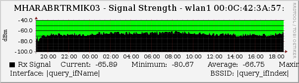

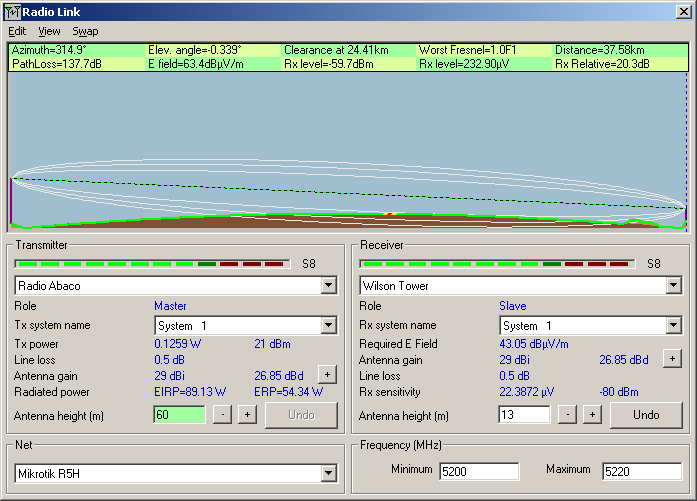

I have a 23 Mile link over water, that is currently V-Pol, and not working too hot. We are slated to swap the antennas to H-Pol, but I am wondering if N would be an optional at all. Radio Mobile puts the link at -60 with 29dbi grids and R5H cards. We have seen as good as -55, and as bad as -90 and lower. Is N ready for prime time? Should I get two SR71-15s to try it out?

The link was modeled with Radio Mobile, but I don’t believe the atmospheric effects over water are taken in to account with this. I have been looking at other options. In my mind I have two options at the moment, trying two SR71-15s, or a Radwin 2000. If N is mature enough on MT, it is worth a try.
I just swapped this link to H-Pol, and it needs to be watched
overnight, but looks good so far. Signal fluctuating between -59 and
-66 on a 20mhz channel, CCQ at 90/90 or better. After flipping to
H-Pol, the channel was still set to 5Mhz, and the same fast start and
slowdown was occurring, the radio would disassociate with poll
timeouts and too many retransmissions. Switching to a 20mhz channel
fixed this.

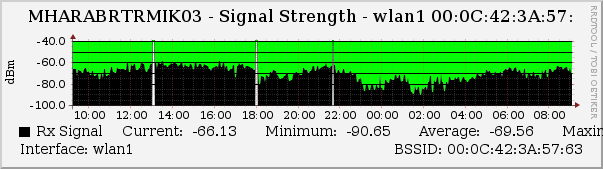

A few hours after posting my message the signal fluctuations came back. I am going to try dropping the higher end to around the same height as the lower end (40 meters ASL or so) and see if things stabilize. Swapping frequencys from 5.8 to 5.3 or vice versa seems to help the issue. I’m wondering if two links bonded, one at 5.3 and one a 5.8 would make sense.

I did read that thread, and had considered the same. At he moment, my plan is to upgrade the 29dbi grids to 32dbi parabolics, drop the higher end of the link to the same height as the remote end to minimize ducting losses, and replace the R5H cards with XR5s for a bit more TX gain. These changes, along with shorter cable runs off of the ODU to the antenna adds 10db to my link budget, which will hopefully put me in a good spot. I’ll keep you posted. For the past 24 hours the link has been running at 5.8Ghz, H-Pol, and been relatively stable, but without much sun today I don’t think the evaporative ducting effects were out in full force.
