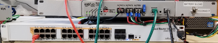

This I performed on a Mikrotik CRS328-24P-4S+RM ( 24 PoE ethernet ports & four sfp+ ports )
My next mod will be on a Mikrotik CRS354-48P-4S+2Q+RM ( 48 PoE ethernet ports & four sfp+ ports & two 40G QSFP+ ports ) This mod will be for my mini-NOCs that do fiber-to-the-home (GPON) where I need/use 10-Gig or faster fiber connections

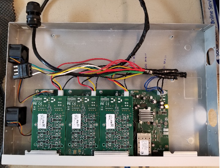

For my CRS328-24P-4S+RM DC-power mod I performed the following:
  • remove the internal AC power supply
  • created a DC wire harness for the CRS328-24P-4S+RM. ( externally I have connectors for external 24-Volt-DC operation and an optional external 48-Volt DC power supply.
    – Note; The CRS328-24P-4S+RM powers up and works fine on 24 volts only without the 48-volts connected. The optional 48 volts is only needed if you want to PoE power a 48-Volt device.

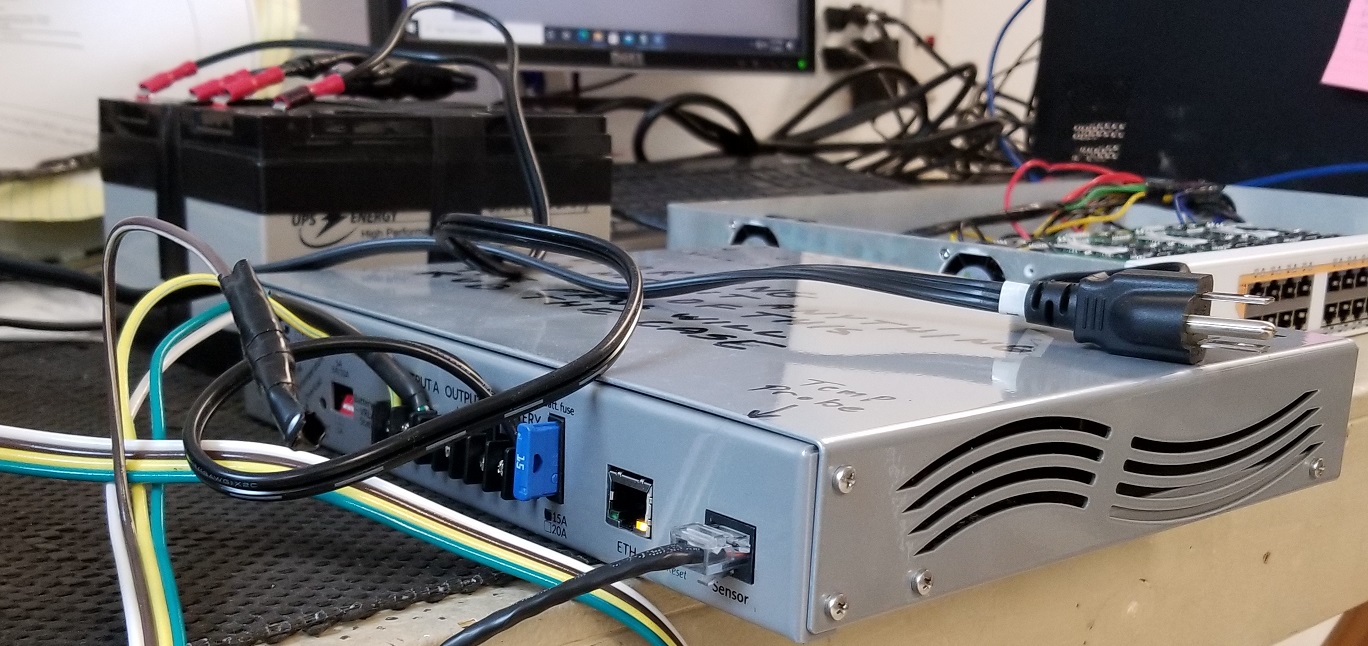

  • For my external 24-Volt DC power supply, I am using an ALG 24-Volt-DC-UPS ( a 24 Volt power supply which will also has connectors to connect external batteries ). Thus when the power goes out , everything keeps running and the world still spins.
    – Note: My battery bank will be large enough ( Amp-hours ) to run a minimum of 1 week without utility power.
I have attached some pictures of my 24-Volt-DC mod on my CRS328-24P-4S+RM.

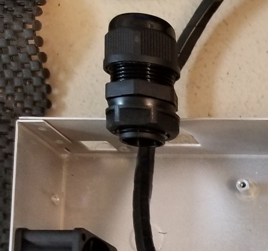

Oooo - I forgot to put the pass-through wire protective grommet where the AC power connector used to go. That will get done soon.
Also , the ALG 24-Volt DC-UPS is the SNMP network version. So I can get and graphs current loads, charge/discharge loads and utility-power/battery/DC-output voltages - and it also has a watch-dog reboot function.
Note: I used a 4-Pin trailer wire harness connector on my modified Mikrotik. Both outside wires are the common/ground/negative lead wire and the two inside wires are +24-DC and the optional +48-DC connectors. This enables me to quickly power-on/off the Mikrotik by disconnecting the connector … fyi disconnecting the 110V-AC outlet on my power supply does nothing because it simply switches over to battery power … In the ALG power supply picture , you can see the brown wire is not connected to anything , this is for the optional 48-Volt DC power if I want to power any 48-Volt PoE devices.
Move over NetPower16-P , here comes Tom’s NetPower-24 ( this mod ), and soon to be followed by Tom’s NetPower-48 !

The DC harness after I installed the wire protective grommet.

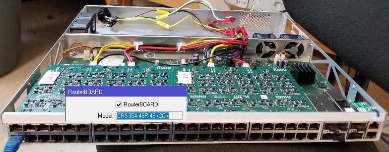

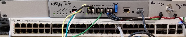

24V-DC-Mod-on-CRS354-48P-4S+2Q+
Said I was gonna do it - and I did.
Now I have a 48-Port PoE out Mikrotik switch ( and four sfp+ and 2Q ) being powered by an external 24-Volt DC-UPS.
This is the perfect solution for one of my remote mountain-top towers where I need about 24 PoE ports and another 24-PoE-disabled ports and five 10-Gig fiber links.
This tower gets some deep snow over the top of the fence every winter. It’s impossible to service the generator during the winter and in the past the utility power has been out for up to 10-Days. So now I have a solution and I also have the batteries to last over two weeks. ( good by 110-VAC UPS , you just don’t have the efficiency to last weeks without utility power ).
I think I will call this one “Tom’s-NetPower-48-4s±2q”
North Idaho Tom Jones

For the heck of it , I started a battery run-down test using a new set of marine deep-cycle batteries that were not fully charged yet. I canceled the battery run-down test after two and 1-half day. The test was however only running at 36 watts. After the batteries are fully charged , I am looking forward to seeing what they can really do on battery only power.
fyi - the power supply I am using has a feature to switch to battery only power , then auto-switch back to AC charging power when the batteries are low.
For me in mu use - this is exactly what I needed. At some of my remote mountain top towers , the snow can get 6 to 12 feet deep during the winter. When running on generator power for that long , it’s then impossible to re-fill the propane tanks. With this solution, I should be able to last about around a week without power ( and without generator ). Then when utility power is restored, who cares how long it takes to recharge the batteries , because recharging the batteries will be always quicker than waiting for summer when a propane tank can get to the tower.

Note - What looks like black or red electrical tape is actually crimped, then soldered connections, then wrapped in electrical tape , then dipped in liquid electrical tape ( aka liquid rubber ).
I also used slightly over-sized DC power wires ( with fuses on the + and - power leads ( the - fuse is 5-Amps+ larger than the + fuse ) , so that I could have a long DC power cable and not have to worry about any voltage drops. If a fuse blows , I want the + fuse to go first, if all hell breaks loose than both fuses can blow.

The conversion of a Mikrotik AC powered router or switch to DC is pretty straight forward.
On the AC power supply , find your common , +24 and +48 wires.
Remove the AC power supply(s). Cut the power supply output wires somewhere that if needed , you can re-splice them together.
Note: The +48 volt stuff is only used for PoE out when set to high. If you are using 24-Volt PoE , then don’t worry about the 48-Volts … However , mark them so that you can later add a second 48-Volt power supply connection if you want to use 48-Volts later.
For my 24-Volt DC power supply , I use ALG 24-Volt DC external power supplies ( two external 100-amp-hour 12-Volt batteries in series to the ALG , then the 24-Volt regulated output from the ALG to the Mikrotik.
On the back of my Mikrotik , where the original AC connextors were located , I put a grommet(s) in the square holes ( made it look better and protects the DC power wires from getting cut on the case where your new power wires will pass through.
Optional , although you can wire directly from the now DC powered Mikrotik to your external power supply , I used some 4-wire trailer wire connectors. Two wires for common , 1 wire for 24 volts and 1 wire for 48 volts. This connector allows me to plug-in an extension cable if needed and also offers a quick way to power-off the Mikrotik ( by disconnecting the 4-wire connector ) - and I can quickly change DC power supplies or swap different DC modded Mikrotiks.
I soldered all the common wires together , also all the 24-volt wires together and all the 48-volt wires together. Then slide some shrink tubbing over each large bundle soldered wires. Then use some tie-wraps to fasten everything so that nothing could pull loose.
Estimate time for 1’st DC conversion is 1 to 2 hours. Additional mods on same model is 30-minutes each.
My DC modded Mikrotiks at my towers have worked flawlessly for years now. And I no longer have to worrly about generators or 30-minute to 2-hour UPS run time. Mine under full load can easily go 1 to 7 days , depending what what batteries I connect to my DC UPS.

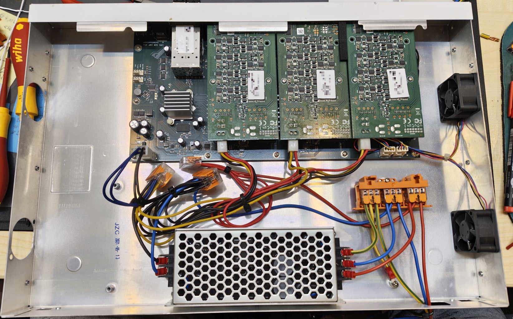

I just want to thank you for your investigation and tests. I did a similar modification on my CRS328:
  • Removed original PSU
  • Screwed a MeanWell RSD100C-48-24 DCDC Stepdown converter in its place
  • Connected all original wires into WAGO 221 distribution blocks (2x 10-Way for COM + 24V, 1x 5-way for 48V)
  • wired it to my central 48V Battery distribution, with its own breaker
I intentionally used only a 100W (4,2A@24V) Converter since most of my PoE Devices use the 48V, only one or two hAP ac² may be used at any time.
I planned to add a plug/socket in place of the old IEC connector, but for now i have it wired direcly.
