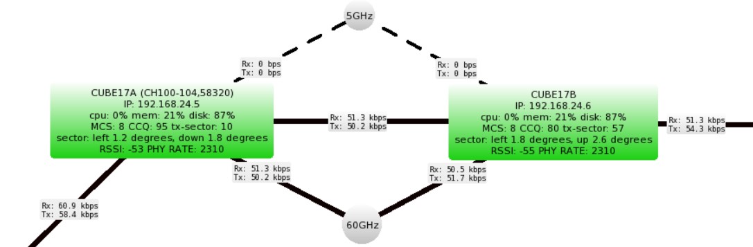

I use https://mikrotik.com/product/cube_60g_ac now, bought as https://mikrotik.com/product/wireless_wire_cube (The 60GHz to 5 GHz bonding/failover is preprogrammed)
Aligning not so easy. 5GHz has only single stream (1S) but is for failover only. 60GHz gives around 1 Gbps bidirectional. (2.3GHz interface rate)
Monitored with DUDE, connected and powered from PoE Powerbox Pro
