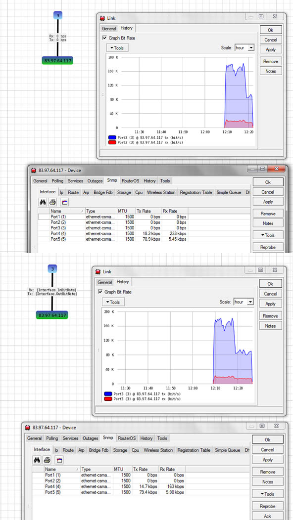

Device i’m probing is 250GS. When I select a port using The Dude 3.6 or 4.0 beta3, it disappears once probed and I get an error on the link.

there are some readings on history graph
on the network map i got only 0 and unknown state
in the snmp interlace port3 is with 0 reading on the next read port 3 is missing and cycling this way 0,missing,0 missing …
i can reproduce same with other ports
ty in advance

Btw I’m customer not bug tracker for free.
snmpwalk shows 250GS reports SNMP stats correctly.
It could be the problem of Dude, we will see what we can do.
Any news on this?
bump ?
UP!!! In the air!
Plus one!
RB250GS (SwOS 1.6) provides information about traffic only on 1st port (uplink), even my note PC is connected to 2nd port
I get information by The Dude under RouterOS x86 5.9
– Added 12/12
Just tried MIB Browser - ifInOctets.1-2 (.1.3.6.1.2.1.2.2.1.10.1-2) and ifOutOctets.1-2 (.1.3.6.1.2.1.2.2.1.16.1-2) showing normally
So, it’s possible Dude’s problem
Hi! do we have updates for probable fix for SNMP reporting? I would really prefer using the dude. I have upgraded and factory reset my equipment with the same problems. Thanks.
solution: don’t use RB250GS if you need Dude+snmp
That’s the best idea. I already dropped this equipment from deploying in my network.
