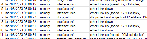

i have a problem with rb260gsp , i have 3 devices on poe ports and 1 with no poe.
sxt ac holds 1gbit for just a few seconds and then drops on 100mbit. if i force only 1gbit , then there is no link. the cable is about 25m long and i did NOT have such problem with rb260gs using gigabit poe injectors.

this is log from sxt.

if i connect the sxt to a poe injector to the hex router, it can hold 1 gbit for months, so it’s not a cable problem.
