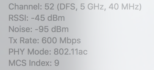

I am sitting 10 feet from and in plain sight of my new hAP AC. Connecting to the 5G AP looks good:

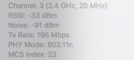

Connecting to the 2G AP looks good too:
