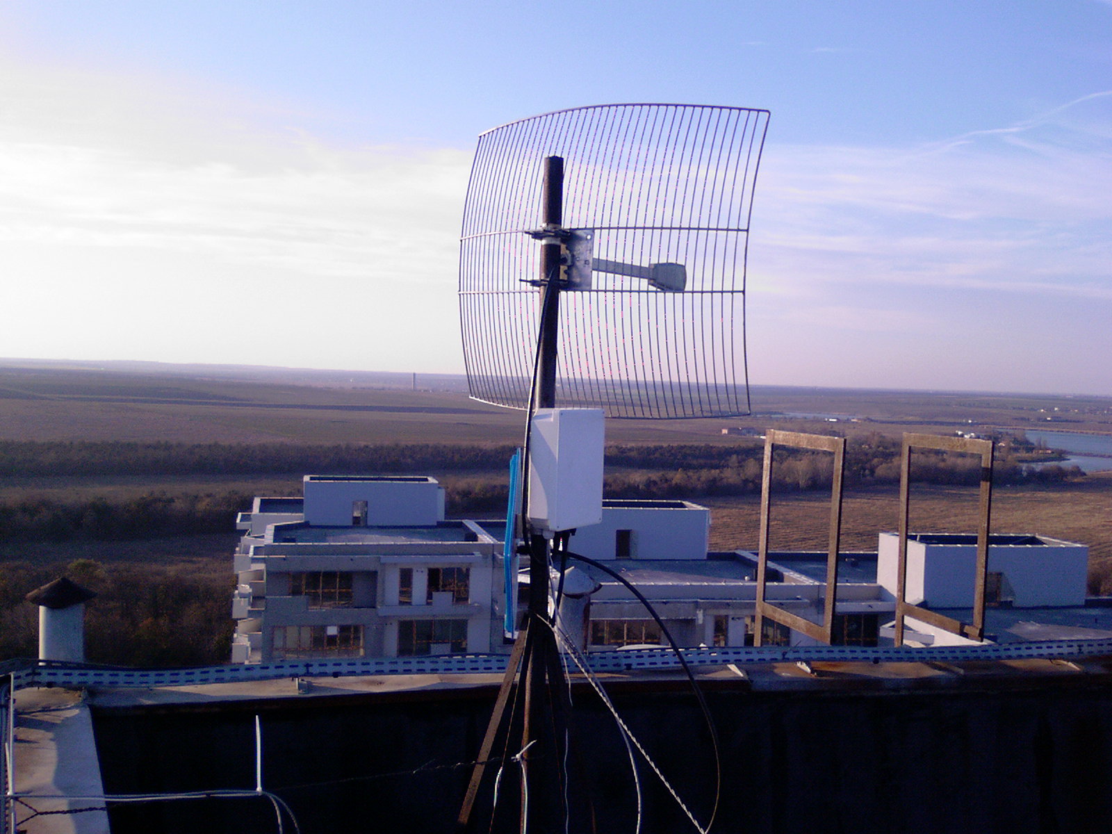

a 24dBi CalAmp grid (2.4Ghz) has the same signal as a 23dBi panel (5Ghz)
a 2.4 ghz antenna cannot be same as 5.8 ghz antenna, they operate on different frequecies
did you try it or you just dream it?
a 24dBi CalAmp grid (2.4Ghz) has the same signal as a 23dBi panel (5Ghz), this is your argument definately they cannot have the same signal unless i do not understand your statement
I’ve just move the pigtail from one antena to the other and rotate it. Same signal and CCQ.
