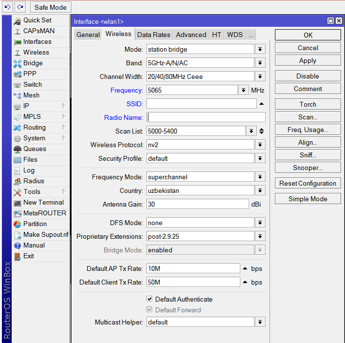

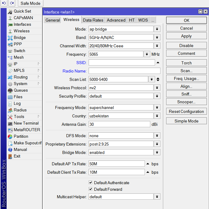

I have setup two NetMetal with below configuration:
but the throughput is not good and also high ping time.
my link is p2p and i need asymmetric bandwidth (send from ap is more than station) the distance is only 2Km.
Please help me for best throughput and low latency.

set [ find default-name=wlan1 ] antenna-gain=30 band=5ghz-a/n/ac channel-width=\
    20/40/80mhz-Ceee country=uzbekistan default-ap-tx-limit=50000000 \
    default-client-tx-limit=10000000 disabled=no frequency=5110 frequency-mode=\
    superchannel l2mtu=1600 mode=ap-bridge nv2-cell-radius=10  rx-chains=0,1 scan-list=5000-5400 \
    tdma-period-size=auto tx-chains=0,1 wireless-protocol=nv2

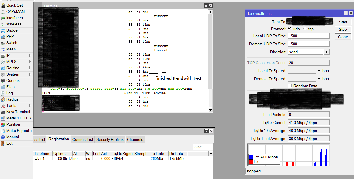

I tried to used best frequency.
Tx Rx CCQ: 60/43 %

That’s quite bad. Looks like interference. Have you checked the spectrum usage ?
