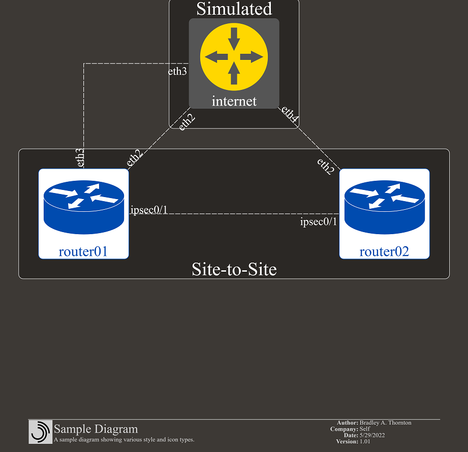

Hello everyone,
I am out of ideas regarding this issue.
Router01 has 2 internet connections and Router02 only has one.
ipsec0 is working fine via router01’s main internet connection(eth2)
ipsec1 will not connect properly (the idea is to have the second tunnel formed on the second internet connection eth3)
I know that in v6 services are not vrf aware(including ipsec) but even with mangle rules or route rule it does not work
Torch on Router01 eth3 will sometimes show me Tx with ip from eth2
If on a router I use the same pre shared key in the identity of both peers(ipsec0 and ipsec1) phase I connects(even without vrf rules)
But on phase II of ipsec, policies will be invalid for the second peer(ipsec1)
I guess it is a peer identity issue before a vrf one. I even tried setting “My ID Type” and/or “Remote ID Type” but to no success (invalid credentials or unknown peer errors)
Does anyone have other ideas?

In my use case:
Router 01 has both connections under nat with no possibility to port forward
Router 02 has direct connection (no nat)
The goal is to have 2 tunnels up one for each of Router01’s WANs
In the config I do not have phase II configured because I cannot get a valid phase I active for the second connection.
Also the config is from 2 chr instances to rule out any other possible influences from the real networks(firewall, nat, vrf etc)
So with these 2 configs only 1 ipsec tunnel reaches phase I.
I suspect the issue is at Router01 as both peers try to connect to the same destination and the identity is not properly managed(that is maybe causing pachet on WAN2 with WAN1 ip as src)
Setting local id and remote id on the peer will not connect for me on the test instances(invalid password or unknown peer even with only one peer setup that connects with auto,auto)
Either this functionality was not intended or is bugged.
