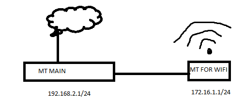

I have two routers in my small office, 1. main router (no wifi interface) 2. router with wifi interface. My wifi cant read my firewall restrictions at main router. Need help, please.
here’s the topology(?) at the attachments. thank you in advance.

Because main router is for LAN PC, and the 2nd router is for cctv. I separate it to reduce the process of main router. and main router has no wifi adapter so I set wifi connections to 2nd router. But the problem is the device connected from wifi cant read my firewall restriction so I can't allow devices (connected from wifi) to connect restricted site like fb, youtube, etc. But devices (connected from wifi) have a internet connection.

What you are doing is very easy and does NOT require the second device to be acting as a router.
It only needs to be an access point-switch from a functional perspective.
Read through this excellent link on vlans to get an idea of some configuration possibilities.
After that you may have some clearer direction and we can help with requirements.
Is wifi going to be used for homeusers, guest users, devices for example.
What else is attached to the router, home users, work users, iot devices, media devices for example??
