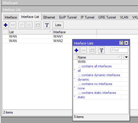

3. As long as both WAN interfaces are interface list members of the interface list=WAN, no need for anything extra.
Let me check that on the mikrotik how its done :smiley:
i suppose the image i uploade is ok.

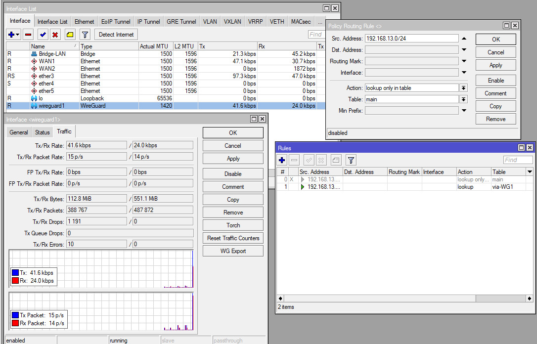

First NAT deleted as informed, About teh connection via WinBox i can reach it without any problem via MAC Adress, just ip stopped working.
I added the rule also but when its like that wireguard is no more in front and internet goes via wan1 network, i got it disabled and internet is via wireguard normal.
I dont know if its my VPN providers issue but i got drops via the Wireguard as you can see. is that a problem to my network? is it fixable?
Okay, strange but if you can reach by mac you have access.
As far as packets, as long as your browsing experience is okay I wouldnt worry too much.
The extra rule is designed to ensure browsing performance is the best it can be.
nm duplicate/
if you mean this extra rule, it disables the vpn in general.

update: i have put Wireguard at 1412 also in mikoritk and at the firewall i added tcpmss 1372, things seems the same. any experience with that? am i putting it in correct place? at the NAT rule its grayed outand cannot put it there.
/ip firewall mangle
add action=change-mss chain=forward comment=
“Clamp MSS to PMTU for Outgoing Packets” new-mss=clamp-to-pmtu
out-interface=wireguard1 passthrough=yes protocol=tcp tcp-flags=syn tcp-mss=1372
I have seen this rule also tried. Starting with putting wireguard mtu setting back to 1420 with
/ip mangle
add action=change-mss chain=forward new-mss=1380 out-interface=wireguard1 protocol=tcp tcp-flags=syn tcp-mss=1381-65535[/color]
[/i]
i put the Wireguard 1420 back and replaced the Mangle as the one you showed, internet seems to work good now but i got one question… why tcp-mss=1381-65535 ?
