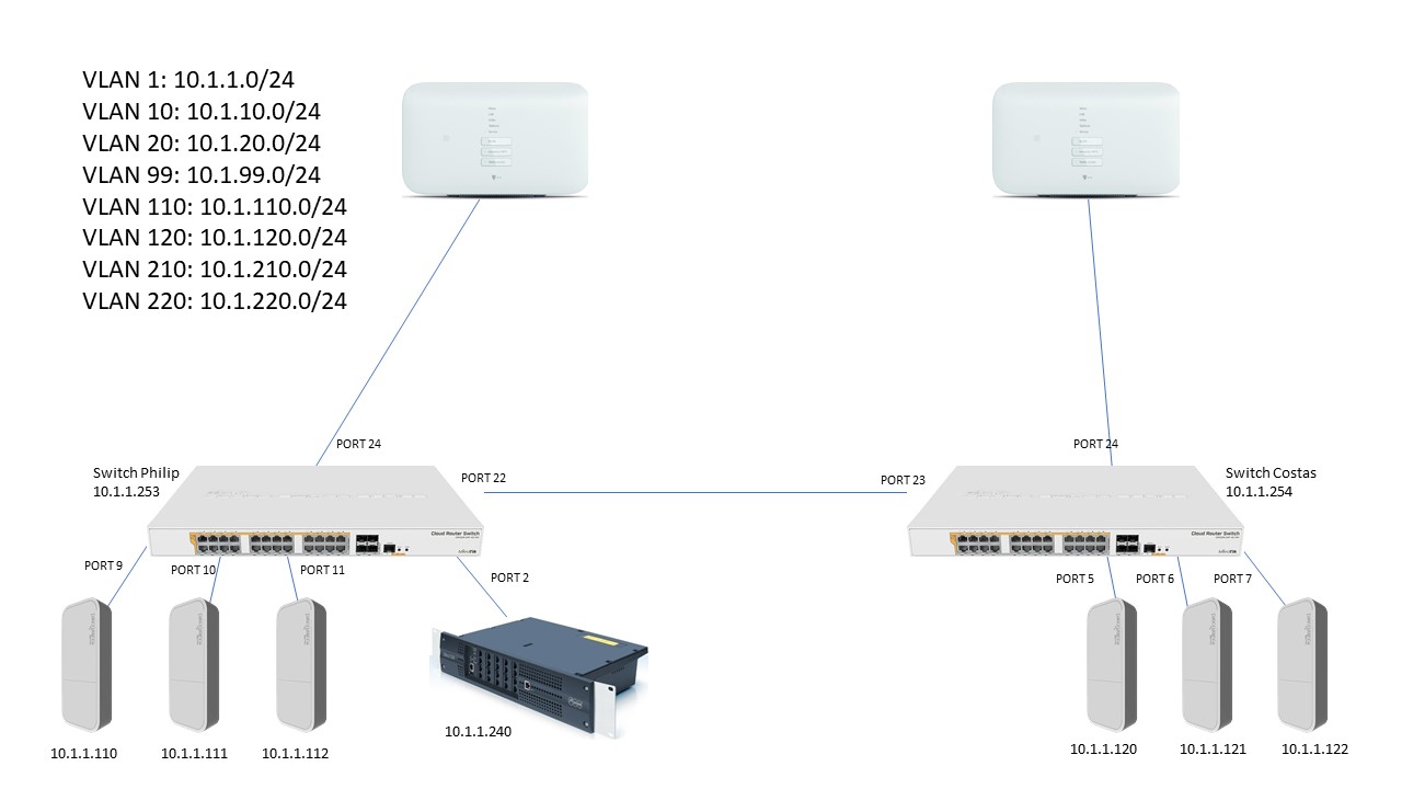

I am trying the last couple of days to find a solution to a problem I have.
Currently we have installed two CRS328 which are connected together. These are installed in two houses.
I have configured various VLANs. Most of them are personal for each house, but we also have at least a couple shared.
By the way, I have changed something and the first VLAN is not 1 but 100.
The problem is that intervlan routing is working partially. The clients from VLAN 20 can access VLAN 100 and vice versa, but the clients from VLAN 10 not.
I am not sure what I am missing in the config.
Here is the config of 10.1.1.253:

/interface bridge vlan
add bridge=bridge tagged="ether22,bridge,ether9,ether10,ether11,VLAN 10 - Philip" vlan-ids=10
add bridge=bridge tagged="ether9,bridge,ether11,ether10,ether22,VLAN 20 - Costas" vlan-ids=20
add bridge=bridge tagged="bridge,VLAN 1 - Native" vlan-ids=1
add bridge=bridge tagged="ether22,bridge,ether9,ether10,ether11,VLAN 110 - PL Guest" vlan-ids=110
add bridge=bridge tagged="ether22,bridge,ether9,ether10,ether11,VLAN 120 - CL Guest" vlan-ids=120
add bridge=bridge tagged="ether22,bridge,ether9,ether10,ether11,VLAN 210 - PL_Shelly" vlan-ids=210
add bridge=bridge tagged="ether22,bridge,ether9,ether10,ether11,VLAN 220 - CL_Shelly" vlan-ids=220
add bridge=bridge tagged="ether22,bridge,VLAN 99 - Security" vlan-ids=99
add bridge=bridge tagged="bridge,ether22,VLAN 100 - Common" vlan-ids=100

add address=10.1.1.253/24 comment=Common interface="VLAN 100 - Common" network=10.1.1.0
add address=10.1.10.1/24 comment="Philip Gateway" interface="VLAN 10 - Philip" network=10.1.10.0
add address=10.1.110.1/24 comment="PL Guest Gateway" interface="VLAN 110 - PL Guest" network=10.1.110.0
add address=10.1.210.1/24 comment="PL Shelly Gateway" interface="VLAN 210 - PL_Shelly" network=10.1.210.0
add address=10.1.252.1/30 interface=ether24 network=10.1.252.0
add address=10.1.20.254/24 comment="Costas VLAN" interface="VLAN 20 - Costas" network=10.1.20.0
add address=10.1.120.254/24 comment="CL Guest VLAN" interface="VLAN 120 - CL Guest" network=10.1.120.0
add address=10.1.220.254/24 comment="CL_Selly VLAN" interface="VLAN 220 - CL_Shelly" network=10.1.220.0
add address=10.1.99.254/24 comment="Security VLAN" interface="VLAN 99 - Security" network=10.1.99.0
add address=10.1.100.253/24 interface="VLAN 1 - Native" network=10.1.100.0

add check-gateway=ping distance=1 gateway=10.1.1.254 routing-mark=Nova_Costas
add check-gateway=ping distance=1 gateway=pppoe-Philip routing-mark=Nova_Philip
add check-gateway=ping distance=1 gateway=10.1.1.254 routing-mark=Common
add check-gateway=ping distance=2 gateway=pppoe-Philip routing-mark=Common
add check-gateway=ping distance=1 gateway=pppoe-Philip routing-mark=Philip
add check-gateway=ping distance=2 gateway=10.1.1.254 routing-mark=Philip
add check-gateway=ping distance=1 gateway=10.1.1.254 routing-mark=Costas
add check-gateway=ping distance=2 gateway=pppoe-Philip routing-mark=Costas
add check-gateway=ping distance=1 gateway=10.1.1.254 routing-mark=CL_Guest
add check-gateway=ping distance=1 gateway=pppoe-Philip routing-mark=PL_Guest
add check-gateway=ping distance=1 gateway=pppoe-Philip routing-mark=PL_Shelly
add check-gateway=ping distance=2 gateway=10.1.1.254 routing-mark=PL_Shelly
add check-gateway=ping distance=1 gateway=10.1.1.254 routing-mark=CL_Shelly
add check-gateway=ping distance=2 gateway=pppoe-Philip routing-mark=CL_Shelly
add distance=1 dst-address=192.168.2.0/24 gateway=10.1.1.254
add check-gateway=ping distance=1 dst-address=xxx.xxx.xxx.xxx/32 gateway=10.1.1.254
add check-gateway=ping distance=2 dst-address=xxx.xxx.xxx.xxx/32 gateway=pppoe-Philip

add comment=Philip interface=bridge mtu=1492 name="VLAN 10 - Philip" vlan-id=10
add comment=Costas interface=bridge mtu=1492 name="VLAN 20 - Costas" vlan-id=20
add comment=Security interface=bridge mtu=1492 name="VLAN 99 - Security" vlan-id=99
add comment=Common interface=bridge name="VLAN 100 - Common" vlan-id=100
add comment="Philip guest " interface=bridge mtu=1492 name="VLAN 110 - PL Guest" vlan-id=110
add comment="Costas guest " interface=bridge mtu=1492 name="VLAN 120 - CL Guest" vlan-id=120
add comment=PL_Shelly interface=bridge mtu=1492 name="VLAN 210 - PL_Shelly" vlan-id=210
add comment=CL_Shelly interface=bridge mtu=1492 name="VLAN 220 - CL_Shelly" vlan-id=220
/caps-man datapath
add bridge=bridge client-to-client-forwarding=yes name=datapath1
/caps-man security
add authentication-types=wpa-psk,wpa2-psk encryption=aes-ccm name=Costas_sec passphrase=*****
add authentication-types=wpa-psk,wpa2-psk encryption=aes-ccm name=Philip_sec passphrase=*****
add authentication-types=wpa-psk,wpa2-psk encryption=aes-ccm name=CL_guest_sec passphrase=******
add authentication-types=wpa-psk,wpa2-psk encryption=aes-ccm name=PL_guest_sec passphrase=*****
add authentication-types=wpa-psk,wpa2-psk encryption=aes-ccm name=CLShelly passphrase=*****
add authentication-types=wpa-psk,wpa2-psk encryption=aes-ccm name=PLShelly passphrase=*****
/caps-man configuration
add country=greece datapath=datapath1 datapath.local-forwarding=yes datapath.vlan-id=20 datapath.vlan-mode=use-tag distance=indoors guard-interval=long hw-protection-mode=cts-to-self hw-retries=4 installation=indoor mode=ap name=CL rx-chains=0,1 security=Costas_sec \
    ssid=LCHome tx-chains=0,1
add country=greece datapath=datapath1 datapath.local-forwarding=yes datapath.vlan-id=10 datapath.vlan-mode=use-tag distance=indoors guard-interval=long hw-protection-mode=cts-to-self hw-retries=4 installation=indoor mode=ap name=PL rx-chains=0,1 security=Philip_sec \
    ssid="Philip Home" tx-chains=0,1
add country=greece datapath=datapath1 datapath.local-forwarding=yes datapath.vlan-id=110 datapath.vlan-mode=use-tag distance=indoors guard-interval=long hw-protection-mode=cts-to-self hw-retries=4 installation=indoor mode=ap name=PL_guest rx-chains=0,1 security=\
    PL_guest_sec ssid="Philip Guest" tx-chains=0,1
add country=greece datapath=datapath1 datapath.local-forwarding=yes datapath.vlan-id=120 datapath.vlan-mode=use-tag distance=indoors guard-interval=long hw-protection-mode=cts-to-self hw-retries=4 installation=indoor mode=ap name=CL_guest rx-chains=0,1 security=\
    CL_guest_sec ssid="Costas Guest" tx-chains=0,1
add country=greece datapath=datapath1 datapath.local-forwarding=yes datapath.vlan-id=220 datapath.vlan-mode=use-tag distance=indoors guard-interval=long hide-ssid=yes hw-protection-mode=cts-to-self hw-retries=4 installation=indoor mode=ap name="CL Shelly" rx-chains=\
    0,1 security=CLShelly ssid=CLShelly tx-chains=0,1
add country=greece datapath=datapath1 datapath.local-forwarding=yes datapath.vlan-id=210 datapath.vlan-mode=use-tag distance=indoors guard-interval=long hide-ssid=yes hw-protection-mode=cts-to-self hw-retries=4 installation=indoor mode=ap name="PL Shelly" rx-chains=\
    0,1 security=PLShelly ssid=PLShelly tx-chains=0,1
/caps-man interface
add configuration=CL disabled=no l2mtu=1600 mac-address=CC:2D:E0:9D:73:BD master-interface=none name="LC 1st floor -1" radio-mac=CC:2D:E0:9D:73:BD radio-name=CC2DE09D73BD
add configuration=PL disabled=no l2mtu=1600 mac-address=CE:2D:E0:9D:73:BD master-interface="LC 1st floor -1" name="LC 1st floor -1-1" radio-mac=00:00:00:00:00:00 radio-name=CE2DE09D73BD
add configuration=CL_guest disabled=no l2mtu=1600 mac-address=CE:2D:E0:9D:73:BE master-interface="LC 1st floor -1" name="LC 1st floor -1-2" radio-mac=00:00:00:00:00:00 radio-name=CE2DE09D73BE
add configuration=PL_guest disabled=no l2mtu=1600 mac-address=CE:2D:E0:9D:73:BF master-interface="LC 1st floor -1" name="LC 1st floor -1-3" radio-mac=00:00:00:00:00:00 radio-name=CE2DE09D73BF
add configuration="CL Shelly" disabled=no l2mtu=1600 mac-address=CE:2D:E0:9D:73:C0 master-interface="LC 1st floor -1" name="LC 1st floor -1-4" radio-mac=00:00:00:00:00:00 radio-name=CE2DE09D73C0
add configuration="PL Shelly" disabled=no l2mtu=1600 mac-address=CE:2D:E0:9D:73:C1 master-interface="LC 1st floor -1" name="LC 1st floor -1-5" radio-mac=00:00:00:00:00:00 radio-name=CE2DE09D73C1
add configuration=CL disabled=no l2mtu=1600 mac-address=E4:8D:8C:CE:D1:A7 master-interface=none name="LC basement-1" radio-mac=E4:8D:8C:CE:D1:A7 radio-name=E48D8CCED1A7
add configuration=PL disabled=no l2mtu=1600 mac-address=E6:8D:8C:CE:D1:A7 master-interface="LC basement-1" name="LC basement-1-1" radio-mac=00:00:00:00:00:00 radio-name=E68D8CCED1A7
add configuration=CL_guest disabled=no l2mtu=1600 mac-address=E6:8D:8C:CE:D1:A8 master-interface="LC basement-1" name="LC basement-1-2" radio-mac=00:00:00:00:00:00 radio-name=E68D8CCED1A8
add configuration=PL_guest disabled=no l2mtu=1600 mac-address=E6:8D:8C:CE:D1:A9 master-interface="LC basement-1" name="LC basement-1-3" radio-mac=00:00:00:00:00:00 radio-name=E68D8CCED1A9
add configuration="CL Shelly" disabled=no l2mtu=1600 mac-address=E6:8D:8C:CE:D1:AA master-interface="LC basement-1" name="LC basement-1-4" radio-mac=00:00:00:00:00:00 radio-name=E68D8CCED1AA
add configuration="PL Shelly" disabled=no l2mtu=1600 mac-address=E6:8D:8C:CE:D1:AB master-interface="LC basement-1" name="LC basement-1-5" radio-mac=00:00:00:00:00:00 radio-name=E68D8CCED1AB
add configuration=CL disabled=no l2mtu=1600 mac-address=CC:2D:E0:96:96:CD master-interface=none name="LC ground floor-1" radio-mac=CC:2D:E0:96:96:CD radio-name=CC2DE09696CD
add configuration=PL disabled=no l2mtu=1600 mac-address=CE:2D:E0:96:96:CD master-interface="LC ground floor-1" name="LC ground floor-1-1" radio-mac=00:00:00:00:00:00 radio-name=CE2DE09696CD
add configuration=CL_guest disabled=no l2mtu=1600 mac-address=CE:2D:E0:96:96:CE master-interface="LC ground floor-1" name="LC ground floor-1-2" radio-mac=00:00:00:00:00:00 radio-name=CE2DE09696CE
add configuration=PL_guest disabled=no l2mtu=1600 mac-address=CE:2D:E0:96:96:CF master-interface="LC ground floor-1" name="LC ground floor-1-3" radio-mac=00:00:00:00:00:00 radio-name=CE2DE09696CF
add configuration="CL Shelly" disabled=no l2mtu=1600 mac-address=CE:2D:E0:96:96:D0 master-interface="LC ground floor-1" name="LC ground floor-1-4" radio-mac=00:00:00:00:00:00 radio-name=CE2DE09696D0
add configuration="PL Shelly" disabled=no l2mtu=1600 mac-address=CE:2D:E0:96:96:D1 master-interface="LC ground floor-1" name="LC ground floor-1-5" radio-mac=00:00:00:00:00:00 radio-name=CE2DE09696D1
add name=GW10
add name=GW20
add name=GW110
add name=GW120
add name=GW99
add name=GW210
add name=GW220
add name=WAN
add name=LAN
/ip hotspot profile
/ip ipsec profile
add dh-group=modp1024 enc-algorithm=3des hash-algorithm=md5 lifetime=1d1h name=profile_1
add dh-group=modp1024 name=profile_2
/ip ipsec peer
add address=xxx.xxx.xxx.xxx/32 name=VPN profile=profile_1
add name=peer5 passive=yes profile=profile_2
/ip ipsec proposal
set [ find default=yes ] enc-algorithms=3des
add auth-algorithms=md5 enc-algorithms=3des name=VPN pfs-group=none
add name=Costas ranges=10.1.20.50-10.1.20.99
add name="CL Guest" ranges=10.1.120.50-10.1.120.149
add name="CL Shelly" ranges=10.1.220.50-10.1.220.149
add name=Security ranges=10.1.99.50-10.1.99.99
add name=VPN ranges=10.1.20.190-10.1.20.199
add address-pool=Costas disabled=no interface="VLAN 20 - Costas" lease-time=1d name="Costas DHCP"
add address-pool="CL Guest" disabled=no interface="VLAN 120 - CL Guest" lease-time=30m name="CL Guest DHCP"
add address-pool="CL Shelly" disabled=no interface="VLAN 220 - CL_Shelly" lease-time=1d name="CL Shelly DHCP"
add address-pool=Security disabled=no interface="VLAN 99 - Security" lease-time=1d name="Security DHCP"
/ppp profile
add bridge=bridge dns-server=10.1.1.254 local-address=10.1.1.254 name=OVPNprofile remote-address=VPN
/caps-man manager
set ca-certificate=CAPsMAN-CA-8D58E7D1FAD5 certificate=CAPsMAN-8D58E7D1FAD5 enabled=yes
/caps-man manager interface
add disabled=no interface=bridge
/caps-man provisioning
add action=create-enabled hw-supported-modes=gn,b master-configuration=CL name-format=identity slave-configurations="PL,CL_guest,PL_guest,CL Shelly,PL Shelly"
add bridge=bridge comment=VLAN20 frame-types=admit-only-untagged-and-priority-tagged interface=ether1 pvid=20
add bridge=bridge comment=VLAN20 frame-types=admit-only-untagged-and-priority-tagged interface=ether2 pvid=20
add bridge=bridge comment=defconf frame-types=admit-only-untagged-and-priority-tagged interface=ether3 pvid=100
add bridge=bridge comment=defconf frame-types=admit-only-untagged-and-priority-tagged interface=ether4 pvid=100
add bridge=bridge comment=defconf interface=ether5 pvid=100
add bridge=bridge comment=defconf interface=ether6 pvid=100
add bridge=bridge comment=defconf interface=ether7 pvid=100
add bridge=bridge comment=defconf frame-types=admit-only-untagged-and-priority-tagged interface=ether8 pvid=100
add bridge=bridge comment=defconf interface=ether9
add bridge=bridge comment=defconf interface=ether10
add bridge=bridge comment=defconf interface=ether11
add bridge=bridge comment=defconf interface=ether12
add bridge=bridge comment=defconf interface=ether13
add bridge=bridge comment=defconf interface=ether14
add bridge=bridge comment=defconf interface=ether15
add bridge=bridge comment=defconf interface=ether16
add bridge=bridge comment=defconf interface=ether17
add bridge=bridge comment=defconf interface=ether18
add bridge=bridge comment=defconf interface=ether19
add bridge=bridge comment=defconf interface=ether20
add bridge=bridge comment=defconf frame-types=admit-only-untagged-and-priority-tagged interface=ether21
add bridge=bridge comment=defconf interface=ether22
add bridge=bridge comment=defconf interface=ether23
add bridge=bridge comment=defconf interface=sfp-sfpplus1
add bridge=bridge comment=defconf interface=sfp-sfpplus2
add bridge=bridge comment=defconf interface=sfp-sfpplus3
add bridge=bridge comment=defconf interface=sfp-sfpplus4
add bridge=bridge frame-types=admit-only-vlan-tagged interface="VLAN 1 - Native"
add bridge=bridge frame-types=admit-only-vlan-tagged interface="VLAN 10 - Philip" pvid=10
add bridge=bridge frame-types=admit-only-vlan-tagged interface="VLAN 20 - Costas" pvid=20
add bridge=bridge frame-types=admit-only-vlan-tagged interface="VLAN 99 - Security" pvid=99
add bridge=bridge frame-types=admit-only-vlan-tagged interface="VLAN 110 - PL Guest" pvid=110
add bridge=bridge frame-types=admit-only-vlan-tagged interface="VLAN 120 - CL Guest" pvid=120
add bridge=bridge frame-types=admit-only-vlan-tagged interface="VLAN 210 - PL_Shelly" pvid=210
add bridge=bridge frame-types=admit-only-vlan-tagged interface="VLAN 220 - CL_Shelly" pvid=220
add bridge=bridge frame-types=admit-only-vlan-tagged interface="VLAN 100 - Common" pvid=100
/interface bridge settings
set use-ip-firewall-for-vlan=yes
/ip settings
set allow-fast-path=no
add bridge=bridge tagged="bridge,ether5,ether6,ether7,ether23,ether22,VLAN 10 - Philip" vlan-ids=10
add bridge=bridge tagged="ether5,bridge,ether6,ether7,ether23,ether22,VLAN 20 - Costas" vlan-ids=20
add bridge=bridge tagged="ether23,bridge,ether5,ether6,ether7,ether22,VLAN 110 - PL Guest" vlan-ids=110
add bridge=bridge tagged="ether23,bridge,ether5,ether6,ether7,ether22,VLAN 210 - PL_Shelly" vlan-ids=210
add bridge=bridge tagged="ether23,bridge,ether5,ether6,ether7,ether22,VLAN 220 - CL_Shelly" vlan-ids=220
add bridge=bridge tagged="ether23,bridge,ether5,ether6,ether7,ether22,VLAN 120 - CL Guest" vlan-ids=120
add bridge=bridge tagged="ether23,bridge,ether22,VLAN 99 - Security" vlan-ids=99
add bridge=bridge tagged="bridge,ether22,ether23,VLAN 100 - Common" vlan-ids=100
add interface=pppoe-Costas list=GW120
add interface=pppoe-Costas list=GW220
add interface=ether24 list=WAN
add interface=bridge list=LAN
add interface=pppoe-Costas list=WAN
add address=10.1.1.254/24 comment=Common interface="VLAN 100 - Common" network=10.1.1.0
add address=10.1.20.1/24 comment="Costas Gateway" interface="VLAN 20 - Costas" network=10.1.20.0
add address=10.1.99.1/24 comment="Security Gateway" interface="VLAN 99 - Security" network=10.1.99.0
add address=10.1.110.254/24 comment="PL Guest VLAN" interface="VLAN 110 - PL Guest" network=10.1.110.0
add address=10.1.120.1/24 comment="CL Guest Gateway" interface="VLAN 120 - CL Guest" network=10.1.120.0
add address=10.1.210.254/24 comment="PL Shelly Gateway" interface="VLAN 210 - PL_Shelly" network=10.1.210.0
add address=10.1.220.1/24 comment="CL Shelly Gateway" interface="VLAN 220 - CL_Shelly" network=10.1.220.0
add address=10.1.252.5/30 interface=ether24 network=10.1.252.4
add address=10.1.10.254/24 comment="Philip VLAN" interface="VLAN 10 - Philip" network=10.1.10.0
add address=10.1.100.254/24 interface="VLAN 1 - Native" network=10.1.100.0

Any help would be very welcome.
Thank you very much in advance!
You have a mess of VLAN interfaces… when you create them in /interface vlan, you have to bind them to some L2 interface. In your case binding them to interface bridge.
Next you never ever add VLAN interfaces to bridge (in /interface bridge port or /interface bridge vlan) as tagged or untagged ports. You shoukd, however, add bridge interface as tagged member of VLAN when you created vlan interface (bound to bridge interface) with corresponding VID (in /interface bridge vlan).
And last: both CRSes are set up for inter-VLAN routing … which means you likely have routing triangles (packet passing one router on the way there and passing the other one on the way back), which messes connection state machinery … and firewall uses that.
Thank you very much for spending some time with this.
So, I guess the best way to go would be split the VLANs to the two switches and make static routes from one to the other for the VLANs each one doesn’t have an IP, right?
BR
Costas
If you don’t have a really good reason for symetrical VLAN setup (e.g. all VLANs are present on both routers), you’d make yourself a favour if you clearly separated both LANs and then you’d establish a few static routes between different VLANs. As things are now, the overlapping addressing (and DHCP server address pools) don’t make things easier either…
