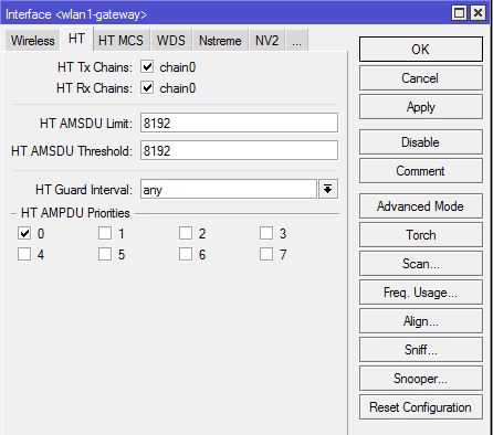

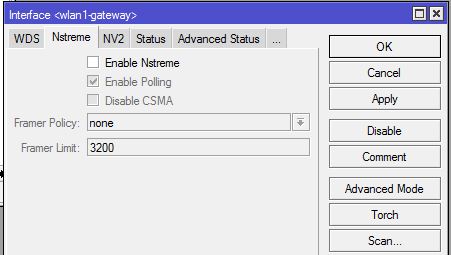

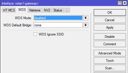

In attachments are more details for wireless that are same on both devices. Thanks in advance :slight_smile:

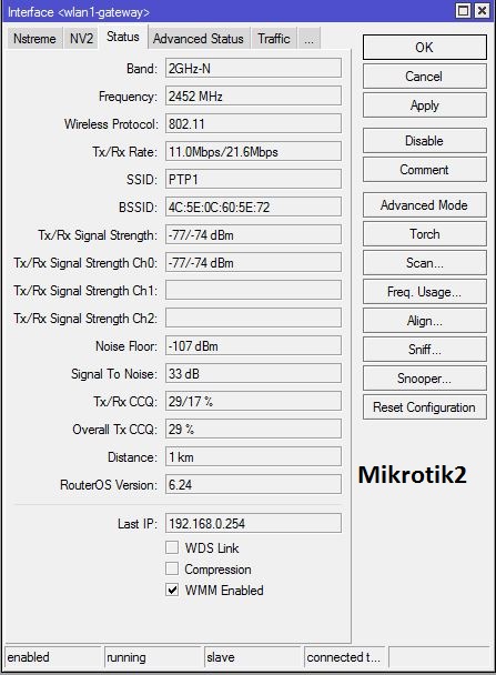

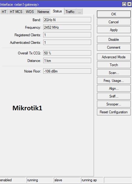

I am not able to switch to 5ghz antennas as both antennas are on roof of building and I cant get there right now because everything is frozen and slippery as its winter. Here are pictures of wireless status from both mikrotiks. Thanks for helping me out :slight_smile:
Signal is too low for the link to work .
