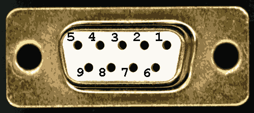

Make serial cable it and didn’t have in next time problem!
http://www.mikrotik.com/testdocs/ros/2.9/system/serial.php
Router Side cSignal Direction Side (DB9f)
1, 6 CD, DSR IN 4
2 RxD IN 3
3 TxD OUT 2
4 DTR OUT 1, 6
5 GND - 5
7 RTS OUT 8
8 CTS IN 7
if you dint have (DB9f)
get from old cable modem or somthing like that :slight_smile:
