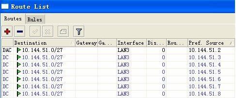

ros3.20(and v3.16) on x86 pc,the motherboard has 4 ethernet ports and 2 fiber ports,all ports are GB port.
ip address >add address=10.144.51.2/27 interface=lan1;
ip address >add address=10.144.51.30/27 interface=lan1;
the result pictue is
why does others(51.3-51.30) not active?

why should they be active? they all point to the same destination and all have the same gateway interface, so the first is active, and others are invalid. maybe you’d like to add 10.144.51.2/32, 10.144.51.3/32, etc. addresses, not /27?
i try to add address with /32,it is active.
add 10.144.51.2/32 ,the route add DAC 10.144.51.2 pref.source 10.144.51.2
then add 51.3/32,the route add pref.source 51.3,and so on.i add 30 ip,it’s route give me 32 pref.source.

at some time,i add address with /27 on another ros(v3.20),it has only 4 enternet ports
add 51.2/27 …51.30/37 (total 30 ip),it give me only one record(DAC 10.144.51.0/27 pref.souce 10.144.51.2)

i added address on the different interface,and the route add one DAC record.
after i reboot ros,the ip>route add DC with a pref.source of the ip.
