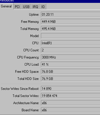

It’s a x86 box, 3ghz, runs fine normally, but then all of a sudden it fails.

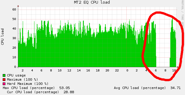

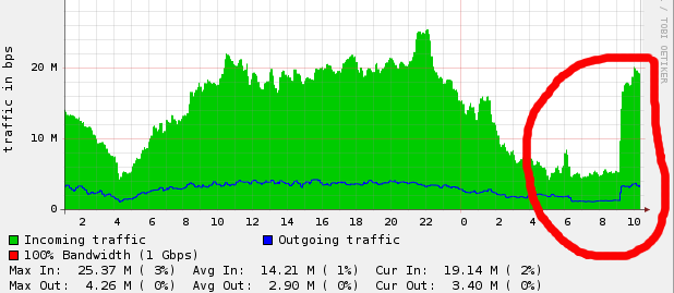

I’ve attached some pics so you can see what I mean.
Red marked areas, at 6:15am, CPU maxes, bandwidth limited.
Only thing in the logs at that time are NTP updates.
Has anyone else seen this issue ?
Just to add, the only thing I could do to fix it was reboot.

Memory is always stable with approx 400MB free.
