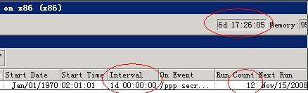

Could you be elaborate on what problems this version is supposed to have fixed? Your graphs were not very clear.

Plans to run two missions a day are problems
For example:
/system script add name=e-backup source={/system backup save name=email}
/system scheduler add interval=1d name=โ€œtestโ€ on-event=e-backup

The graphs are clear, with a 6 day uptime and the job scheduled to run every 24h, there should be only 6 โ€œRun Countsโ€, the image shows 12 runsโ€ฆ

This scheduler bug has been around for most of v3! see: http://forum.mikrotik.com/t/scheduler-runs-twice-for-no-reason/19926/1 it can have a snowball effect if your 24hr or even 48hr timed scripts call other scripts in their runtime - you will end up with the same script running twice concurrently and on some occasions this will crash a V3 router.
17 sub releases and this is still a big problem. I wrote to support at V3.6, V3.11, and 3.15 the replys were โ€œit will be fixed in a future releaseโ€. How many releases exactly? will this be fixed before V4?
I read somewhere that this problem only appears when the script is scheduled to run in a round time, finished with :00 minutes. A workaround would be set the script to run at broken times like 13:01 pm instead of 13:00 pm. I donโ€™t use scheduled scripts so I canโ€™t tell if this is true but doesnโ€™t hurt to tryโ€ฆ :slight_smile:
Unfortunately this is not the caseโ€ฆ Some of our scripts are scheduled to run 11:58pm and 12:04am etc but they still run twice.
We even tried running the same script via two separate schedulers each set at 2 day intervals but starting opposing days. Even at 48hr (2d) scheduler runs the script twice.
