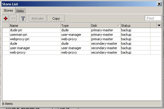

I’m using RouterOS 3.27 x86 and all the sudden my stores don’t show any active. If I activate (by winbox or console) I can’t tell when the store has activated. When I first boot the router it shows correctly, but after some time no more stores are active. If I check status in script or console it shows “backup” for all stores.

only IDE. Primary-master and Secondary-master are both IDE drives. Primary master is an 8gb drive, and secondary-master is a 20gb drive.

 /store> print detail
Flags: X - disabled, A - active
 0   name="user-manager1" type=user-manager disk=sata1 status=backup
 1   name="dude1" type=dude disk=sata1 status=backup
 2   name="web-proxy1" type=web-proxy disk=sata1 status=backup
I’ve tried to force them to active, without much success.

This problem exists in 3.27 and 3.28 (that I’ve tested). I had a USB stick plugged in but not using it. Each time I rebooted stores would show up fine then show “backup” status after some time. When I removed to USB stick and rebooted, it’s been almost 24 hours and the problem has not occurred. Now the ONLY 2 drives I have are IDE 8gb and 20gb, no USB at all.
I’m wondering if plugging a USB stick in causes all the stores to show “backup” status after some time.
I will report back after running for awhile to check this as a workaround for now.
I’m using Mikrotik 3.28 without USB for about 6 days and I still get all stores showing up as “backup” after some time. All drives are IDE drives.
