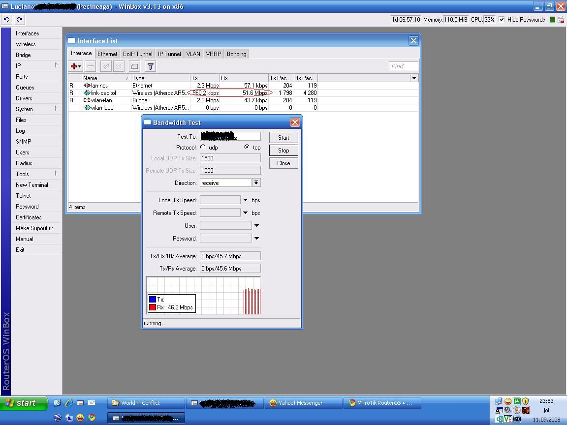

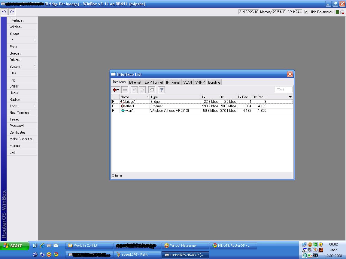

what are you talking about man? Offcourse you can get 150mbps on wireless with RB433. 3x50mbps how much do you think it is? Its not about one wireless link, it’s about 3 links!!! And i have 55mbps TCP trafic on one wireless link and you can search the forum and you will see i’m not the only one.
Now watch and cry. And remember that a FTP transfer is faster than btest. And pay attention to the CPU usage, it’s only 24% so 150mbps is possible.The pictures are from a bridge between an RB411 and a 1Ghz P3.
And galaxynet try harder.
InoX -
